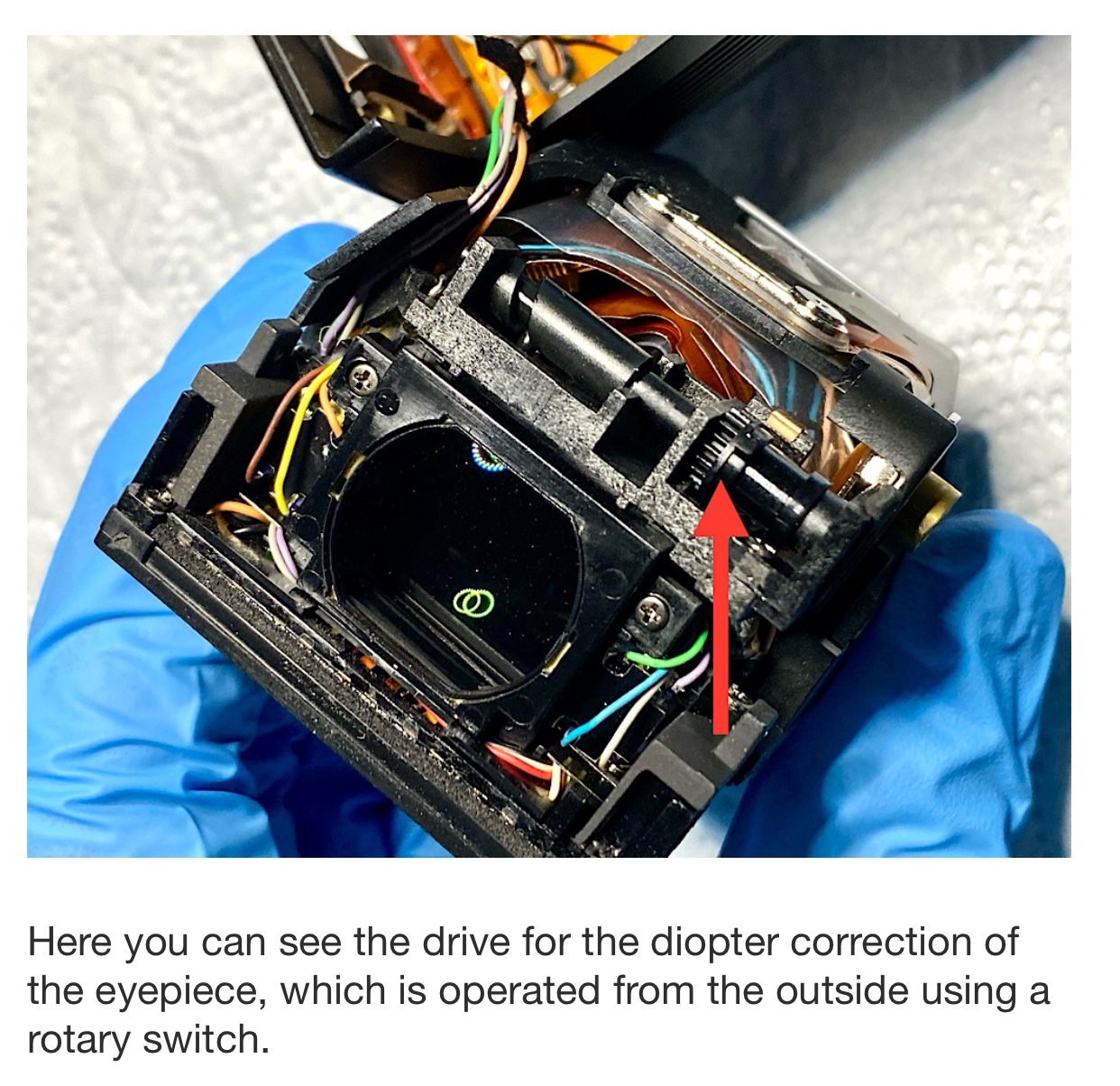

It should be repairable, the DP-20 viewfinder is easy to open and the place with the diopter drive is accessible.
See (also for disassembly):

Is there any way to finesse this without removing the finder cover? The wheel remains immovable and I am afraid of pulling too hard to loosen it up. I think that I could get the cover off, but how to free it up once I get the cover removed.
I don't think it can be repaired from the outside, as I suspect the drive is jammed. The only way to fix this is to take it apart.
I would open the viewfinder, check where the problem is and if it can't be repaired, reassemble the viewfinder.
Have you ever had an F4 that couldn't adjust the diopter?
No, but I have a DP-20 where the viewfinder cover doesn't move. This should be fixable, but it will require disassembly too.
Since I went digital with the diopter adjustment I have gotten used to focusing without my glasses. The adjustment on my F4 seems to be for normal vision and when I focus with my glasses on the screen appears sharper and I can see the corners of the screen with my glasses. The F4 seems to have a High Eye Point viewfinder.
Yes, it's an HP viewfinder. I use it with my progressive lenses. But I prefer it without glasses, as they do limit the viewfinder image somewhat.
If I can help you from a distance to open the viewfinder, I'd be happy to do so here in the thread. Anyway I think my post (first link) should cover everything important.
