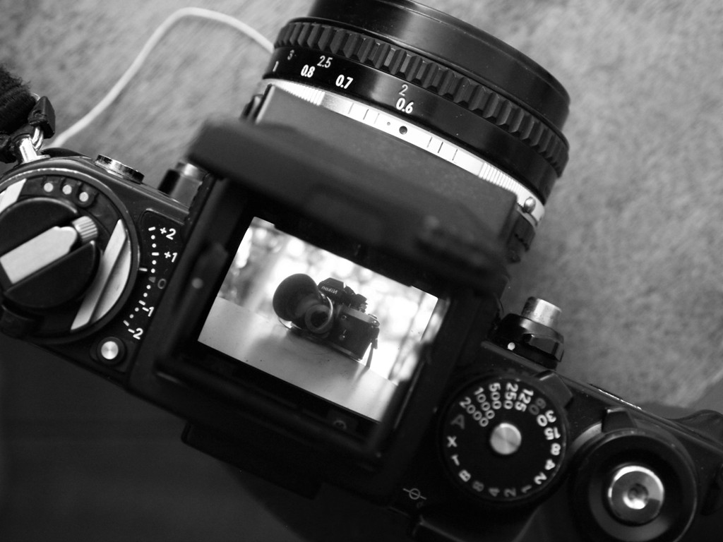

I have the f2sb with the d-p3 head and its great. Have no problem reading LED's in bright sun or low light, the speeds & aperture are harder to see. Meters to 8 secs accurately and fast.......but now I have an f3 its going to be hard to choose.....haven't used any other f2.

It might be easier to choose between an F2 and an F3 when it comes time to accessorize, especially with respect to motor drives. MD4's for the F3 are cheap and plentiful. MD-2/MB-1's for the F2 are neither cheap nor plentiful. It's a superb motor drive combo though and still much cheaper than it used to sell for back in the days of film.
