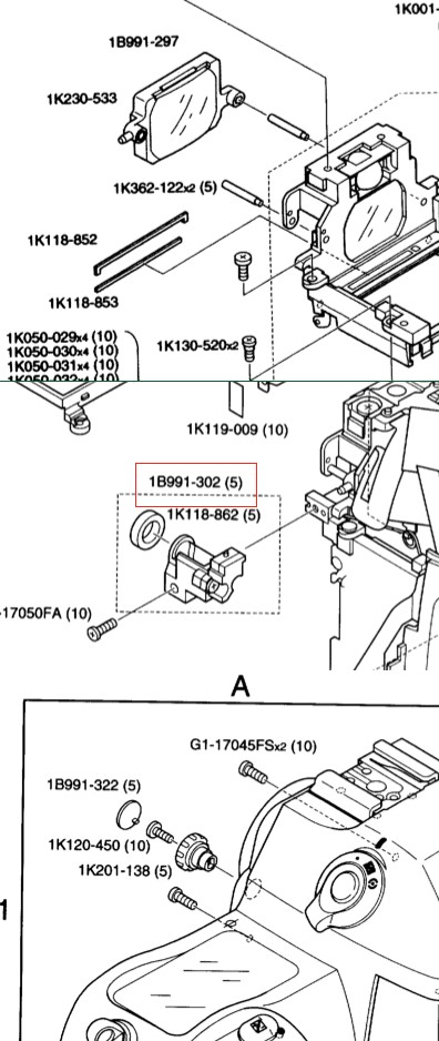

My Nikon F100 has a diopter adjustment knob right next to the view finder. Nikon kindly says, in the manual, DO NOT poke your eyes adjusting it. Yes, I was careful and did not poke my eyes as Nikon feared. But, I also found out, as I pulled it and turned it (like I'm supposed to), nothing changed. I screwed a round protective glass out then watched a rectangular lens inside. As I turned the knob, it did not move. In comparison, doing the same on my second F100, I can clearly see a piece of glass move forward and backward.
Obviously, that lens decoupled itself from the shaft attached to the adjustment knob. Does anyone know how EXACTLY these things attach to each other? I intend to send it to Nikon for repair but I'm curious what is actually broken. This body was sitting in my closet for about 8 months unused, and last time I used it, it worked. So I know nothing was forced. It seems something "just fell off....."

This may be of some help. Some pictures from the parts list.

On careful VISUAL inspection, it appears my know IS coupled to the shaft securely. So I presumed the issue is the connection between the shaft and the mirror. My local repair person says there are cheap plastic gears there and they often crack. Since he can't buy the parts, he refereed me to Nikon itself.
Sent the camera in and the repair quote was $200.
I OK'd it since I like this camera and they will clean and adjust as well. The job is now on hold for parts.
