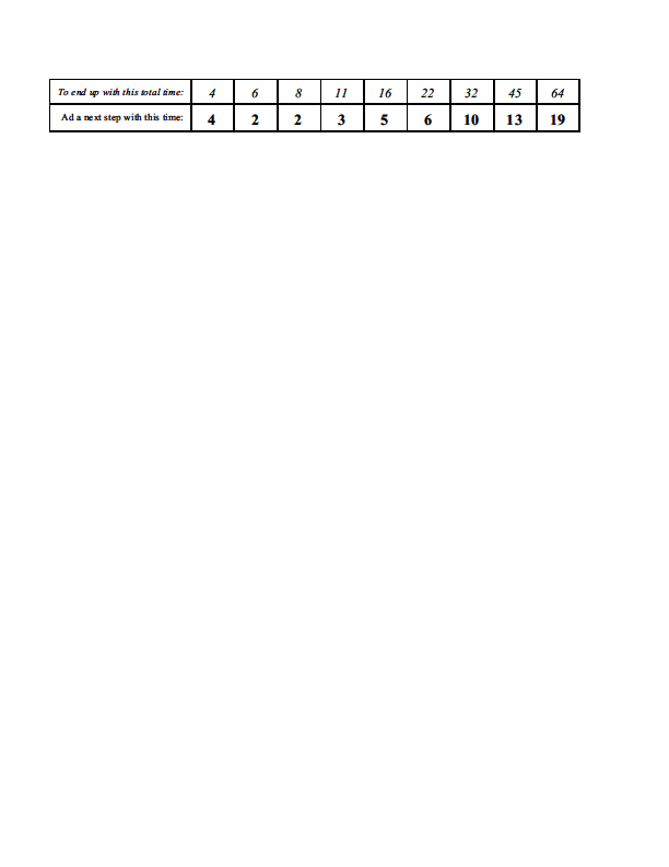

any timer and the attached list can be an f/stop timer
  • f-stopTable.pdf

If you need something to help you conveniently remember a progression of half stops of exposure time, then this progression might seem familiar:
2.8, 4, 5.6, 8, 11, 16, 22, 32, 45, 64, 90, 128 ... (all in seconds).
I don't know about the rest of you, but I have problems accurately counting 2.8 or 5.6 seconds... I basically do what Matt suggests, though, just rounding the numbers a bit:
3, 4, 6, 8, 11, 16, 22...
Actually, I don't like print exposure times much shorter than 15 seconds, so one could just start at 11:
11, 16, 22, 32, 45... Note, however, that this is in a progression where every number is roughly the product of the square root of 2 and the previous value, about a 40% increase every time.
Often, I need test strips in finer gradations, so I'll make a strip at approx. 30% intervals (each number is 1.3 x the previous one):
10, 13, 17, 22, 28, 37, 48... (I count 10, 3, 4, 5, 6, 9, 11...)
Or in roughly 25% intervals, where each number is roughly 1.25 x the previous:
10, 13, 16, 20, 25, 32, 40, 50... (I count 10, 3, 3, 4, 5, 7, 8, 10...)
Same idea, but I still think that using percentages instead of f-stop numbers (which are unwieldy because they're based on the square root of 2), is more flexible. I can't figure third-stop intervals in my head quickly...
I usually start at 6 anyways :smile:.
And by the way, if you are in the habit of using a single exposure, and progressively covering more and more of your paper, you can use this progression:
