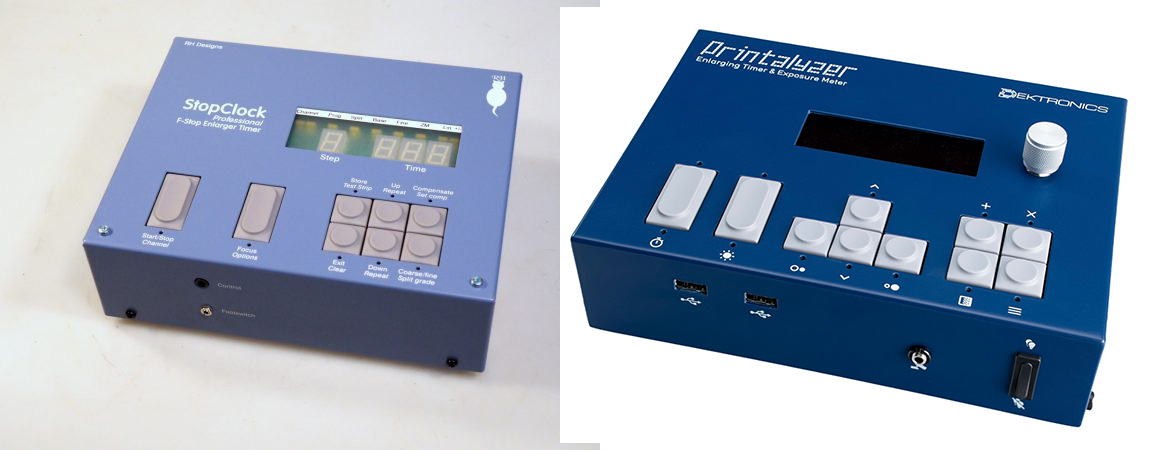

That looks amazingly identical to the RH Designs Stop Clock. Is this the same person?
No, he's not. You may want to join his discord if you'd like to ask him some direct questions. I recall a few discussions about the differences. It has been a while, though.
He must be using either some of the same suppliers or bought surplus from RH designs.
As this thread just came to my attention, I figured I should jump in and offer my own comments.
I'm not using the same suppliers at RH Designs. However, I am using the same buttons. They're made by Marquardt and from the 6425 series. I picked them because I really like how they feel. Its a similar touch to a computer keyboard, but with flatter key caps. I haven't really found anything else I like better that's an off-the-shelf part.
Though I will admit there's a lot of physical design similarity. That's because the design just makes sense from a hardware perspective, and is sufficiently simple to dial in, and because I used RH equipment before jumping into my own project. Of course the RH boxes were all designed in the mid 90's, and my hardware is contemporary, so the innards are completely different. The firmware on mine is also user-update-able, so I expect the actual user experience to evolve over time.
Those buttons really do feel great; can't argue that fact at all.
Yeah, it took a little bit of work to figure out what they were, but I showed pictures to some friends who thought they looked familiar from a different product and we eventually nailed it down.
