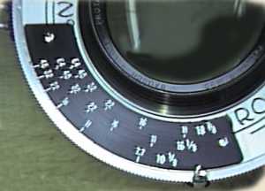

I am planning a compact and cheap lens kit like 210, 270, 305 all clarons... and i have a compur 1 where they all fit nicely, how could i do a f stop scale for the shutter (since i plan to use only that one and doing some screwing and unscrewing as i change the different cells), has anyone did this already? i know that convertible lenses have something like this, is it possible?
thanks!

ok it has been done!!!! i think i will try to make one myself, it seems a nice project...
it would be nice to have scanned scales for different lenses, different focal lenght´s and different shutters, i think i will do it for the lenses and shutters i own!!! that way it would be easyer for new shuttering projects!!!
working for the community!!! :smile:
scans are welcome!!!
