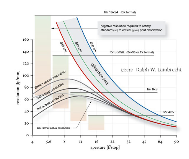

I understand the function of the selection of aperture while shooting but other than controlling the amount light, what else does different apertures do when printing?
You received many good answers already. Here are my two cents:
The typical rule for lenses is that the open aperture is only good for framing and composition. One must stop down a couple of stops to get the best lens performance. While stopping down lens aberrations are reduced but aperture diffraction is increased. A 35mm lens offers the best compromise between the two somewhere between f/8 and f/11, regardless of the widest aperture the lens may offer, see attached graph. For many enlarging lenses, this means to stop down no more than one stop. For many taking lenses, it means 3 stops or more.
The aperture also controls the depth of field at the baseboard and the depth of focus at the negative plane. As stated already, the depth of field is relatively large and of little concern (forget putting a piece of paper under the focus finder, it's meaningless). However, the depth of focus is very small and critical, that why glassless carriers are very difficult to make a truly sharp image with.

sandermarijn
Oct 19, 2005
704
Leiden, Neth
I've just been staring at that graph for a few minutes (longer?). Very nice graph indeed, but not intuitively clear to me. Those grey lines, are they taken from the typical 6-element lens MTF data? "Actual" in that graph means "as computed from typical enlarger lens specs"?
The coloured bars seem to indicate that in the 35mm format only some kind of (purely hypothetical!) diffraction-limited superduper lens @ full aperture would be able to produce results (resolution) that stand the most of scrutiny. That's pretty shocking, I never knew that.
Can you elaborate a bit on that "actual" part?

I've just been staring at that graph for a few minutes (longer?). Very nice graph indeed, but not intuitively clear to me. Those grey lines, are they taken from the typical 6-element lens MTF data? "Actual" in that graph means "as computed from typical enlarger lens specs"?...
Sorry about the confusion, the graph is about taking lenses, not enlarging lenses, and yes, the data is from typical lenses (Nikon, Hasselblad, Schneider) on typical film after normal processing.
...The coloured bars seem to indicate that in the 35mm format only some kind of (purely hypothetical!) diffraction-limited superduper lens @ full aperture would be able to produce results (resolution) that stand the most of scrutiny. That's pretty shocking, I never knew that...
True indeed, that's why we see a huge difference between 35mm and 6x6 enlargements but a smaller difference between 6x6 and 4x5.

Sorry about the confusion, the graph is about taking lenses, not enlarging lenses...
That's only good because now I have an excuse to reexamine that wonderful graph :smile:
Now that I do: the graph also shows that resolution wise 6x6 is sort of optimum (if no cropping, assuming good lenses, etc). Going smaller you loose resolution, bigger is overkill. Of course that's only resolution, tonality would be yet another story.
It suprises me also how close in optimum resolution the MF lens is to the 35mm lens. I always thought that the difference was bigger. Comparing my Contax G 45mm to the Hasselblad C T* 80mm (both Zeiss), the difference feels like more (but then there is so much involved in these subjective comparisons that such an 'intuitive mistake' should not be surprising I guess).

...It suprises me also how close in optimum resolution the MF lens is to the 35mm lens. I always thought that the difference was bigger. Comparing my Contax G 45mm to the Hasselblad C T* 80mm (both Zeiss), the difference feels like mor...
For our comparison, we used an average of the best lenses we could get our hands on. For 35mm, we used Nikon and Leica lenses. For 6x6, we used Mamiya and Hasselblad, for 4x5 Nikon, Schneider and Rodenstock.
Are you comparing your lenses at the same magnification? If you compare 8x10 prints made from both, the difference will be bigger, because the 35mm neg is enlarged more, but comparing their negs under a microscope, the difference will be smaller.
Also important to note is that this is not a lens test. It is a system test, the system being lens, film and development. Aerial images of lenses have a much higher resolution, but we aimed a more practical comparison.

Are you comparing your lenses at the same magnification? Also important to note is that this is not a lens test. It is a system test, the system being lens, film and development. Aerial images of lenses have a much higher resolution, but we aimed a more practical comparison.
I inspect all my negs under a loupe. Maybe this is a bit silly but I like doing it, and it complements the scan that I always make before (in case of some negs) making a print.
The loupe inspection always tells me that the 35mm-system lens has higher resolving power/better micro contrast/what-you-want-to-call-it than the MF lens. (This is comparing Contax G lenses to Hasselblad V). Which is obviously a judgement unfair towards the MF lens, because images taken with that lens will see less enlargement than the 35mm negs.
The grey lines in your graph are pure resolution figures of each system, i.e. not taking into account that the smaller system will face tougher scrutiny through enlargement. This is the same case as inspecting with a loupe- no normalization for final print size there either. I was surprised with your graph because, unlike my loupe-comparison, those plots show not a huge difference in resolving power between systems, at least not as much as I think I see with my loupe.
The problem is of course that my loupe inspections are subjective and unquantified, whereas your graphs are the opposite. I therefore have no right to be surprised, yet I still am :surprised:
I am aware of yours being a system test, not (just) a lens test. That's the thing that makes your graph so interesting. Normally people say "oh, that Hasselblad lens is no good, just look at the MTF- even my Canon beats that by a mile" and they don't mention the difference in magnification. Your graph shows MTF *and* takes into account magnification (through the bars).
