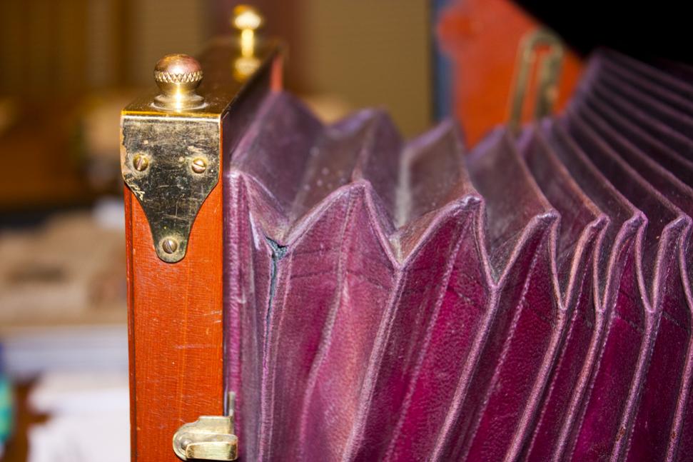

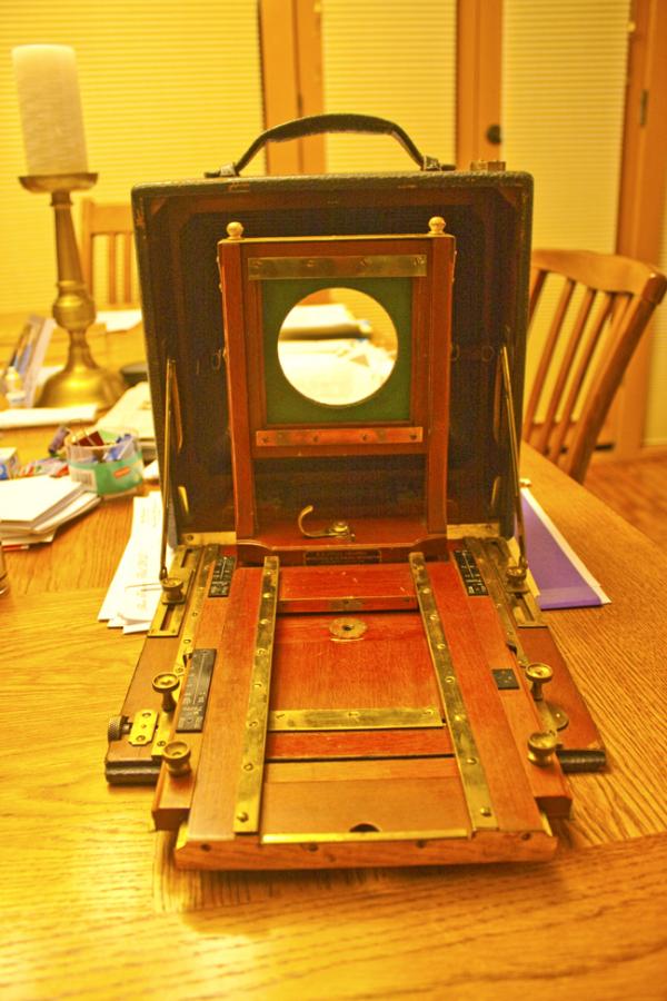

I just acquired a #8 RB Cycle Graflex as part of a #8 Cirkut Camera Outfit. I'm trying to refurbish it and get it in working order.
The biggest problem is the bellows - pin holes, brittle leather and a 3" long tear in the first fold back from the lens board.
I've got the camera 99% apart for a good cleaning, metal polishing and wood restoration, but so far the bellows stump me. I don't see how they are attached in the front, other than glue, and it appears the liner was glued and nailed to the back, and perhaps the leather glued to the back under the wood strips the liner is glued and nailed to.
Anyone ever worked on one of these? Any idea how the bellows are attached, and how to remove them?

There might be some screws inside the camera/bellows, hidden by the bellows folds. Or possibly under the felt in front, but the first is more likely

Jamie,
I found screws in the front and removed the lens board housing from the bellows, but there is still a board attached to the bellows from which I can see a glue line. Looks like I'll have to remove the glue. The back is a complete mystery. I can see nail heads, so most likely it is both glued and nailed in place. Gonna be a big, careful job. Thanks. Loren

Never seen a manual just for the camera, but you can just play with it to figure out operation. If you have specific question just ask. I've used the camera a fair amount. Probably shot a few hundred rolls of film at this point, and some sheet film as well. Likely the inner front board is just glued, if it is like my #10.
I haven't taken the bellows off on my 8's or 6's, but figure they are similar.
Len Robertson
Dec 2, 2005
154
I looked at the Cycle Graphic for my #8 Outfit. I'm not sure about the front bellows attachment, but I suspect it is just glued on. Probably with hide glue, which softens in water. You might try laying a damp tissue along the glue line for a few minutes, then gently try to slip a dull knife blade between bellows and wood frame. The rear attachment looks just like an early 8X10 Deardorff I took the bellows out of. You are right - glue and nails. I guess when they built these cameras, they weren't thinking of making bellows replacement easy for someone 80 years later. I don't remember how I pulled the nails on the Deardorff. I'd try slipping the tip of a cheap import jeweler's screwdriver under the nail head and pry up. Use folded cardboard or something to pry against so you don't damage the wood. Once the head is up a little, a pair of small wire cutters (hobby shop or electronics) can be used to pry the nail the rest of the way out. You don't want to squeeze hard enough on the handles to cut the nail off. Needle nose pliers might work well too. The nails in the corners inside the revolving back frame look like fun to get to. You may have to unscrew the whole frame and get it out of the way. I hope you can take pictures as you do this and post it for the rest of us. I don't think it will be really difficult, just very time consuming. But then that is almost the definition of Cirkut photography. Keep us posted on your progress.

Just an update to my progress: I stripped the #8 Cycle Graflex down to a pile of wood and screws.
I have a new FS mirror to replace the broken mirror in the little rangefinder.
I discovered that the reason for the chittering while turning the bellows extension knob was due to many cracks in the wood base, screws that wouldn't hold, and one of the brass bellows rails being bent. Coming from Michigan, the camera probably spent most of its life indoors, a heated dry environment in the winter and a hot humid environment in the summer. Enough to crack anyone's base.
I spent days getting liquid hide glue in all the cracks and clamping the base. Then I drilled out all the screw holes. I bought a chunk of Mahogany at the House of Hardwood in West Los Angeles, and made 20 or so tapered plugs. I glued the plugs into the drilled out screw holes, planed them down to the base surface with a tiny finger plane. I'm at the point now where the areas where the finish was worn off and the area under the rails and hinge, where all the plugs are, have multiple coats of shellack. I still need to get a few more coats of shellack into the brass gear shaft groove, which I cleaned. Since much of that is end grain it has just soaked up the shellack and still looks unfinished.
Next I'll buff those areas out with 000 steel wool and then use Howard's Mahogany Restor-A-Finish with 0000 steel wool to make the entire base look uniform without stripping and totally refinishing - I think it is supposed to "reflow" the finish.
When the rails and other brass parts go back on (after cleaning and polishing with Simichrome Polish), all of the plugs will be invisible, but the screws should hold like when the camera was first made. When I made and installed the plugs I made sure the grain paralleled the surrounding grain. I didn't make plugs from the end grain, so there shouldn't be any splitting. I also have a tapered screw starter bit to make tiny pilot screw holes.

The camera shutter cloth arrived from "Aki-Asahi," and it is beautiful! The only thing is that it isn't too flexible - too flexible probably isn't a good trait in a shutter curtain. The rubber+silk may be, but since I've decided to replace the bellows - see below - it is moot.
I finally got the bellows off. As Len guessed, the bellows was folded over the front removable board that attached to the front standard, and hide glued in place. Boy, is old hide glue sticky and nasty to get off!
I bought a hand held clothing steamer at Bed, Bath & Beyond for $19 and used it to remove the felt from the board, and then the bellows. The only downside of this approach was that the steam promptly shrunk the felt. It will probably work with the 5x7 Cycle Graflex now, but not my #8. No big, since the felt can easily be replaced.
The rear stumped me for a while. It appears that the wood the bellows attaches to are narrow blocks of mahogany glued to the camera frame. They are notched so that there is a lip extending the length of each side - like an "L." The bellows liner is folded over a narrow strip of cardboard and the leather glued over that. The double strengthened bellows end was simply nailed to the frame in the notch, no glue.
You hear about the craftsmanship from those day, but whomever made the camera didn't do such a hot job. The nails look like tiny carpet tacks and weren't always nailed properly, especially in the corners - which would be the hardest place to drive a nail. The frame was split on one side, which I glued together. Some nails came out easily, others lost their heads in the process. Some were in the proper place, others were cockeyed or in the lip, not the notch proper.
