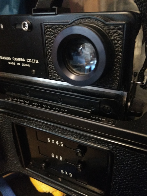

I am having a hard time finding a replacement for the eyecup on my Mamiya Press (Super 23) .
I have tried eyecups for Nikon D800 (and the likes) but they are too narrow. Opening diameter 22mm, while the Mamiya is approx. 24+mm.
Only the rubber cup is needed. The screwring for fastening is attached to the viewfinder already.
Anyone got tips/solutions for replacement eyecups for Mamiya Press and other older cameras?
