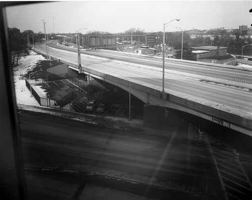

I'm just starting a project where I'm trying to get exposures in broad daylight of up to an hour.
so I purchased a cheap foil solar filter, and constructed some sort of way to mount in on the front of my schneider angulon 90mm.
I'm doing tests out the window as we speak because it's still cold out.
It worked fine using efke 25 black and white film (I think at f/11 and 1 hour) but the slowest color film I have is 160s. I hesitate to use Velvia because I have no confidence in the process's ability to get a technically correct exposure.
Anyways, anything I should be aware of? I'm worried about color shifts from the filter or the long exposure times.
here's the black and white version

Well, I printed it. I honestly couldn't tell much difference between the 7 minute exposure and the 1 hour exposure.
The only main difference is a giant greenish flare in the center. Like, it's really bad, I'll scan it tomorrow. Prof and classmates actually liked it a lot but I don't really. Which means there will be dual black and white and color images until I decide.
