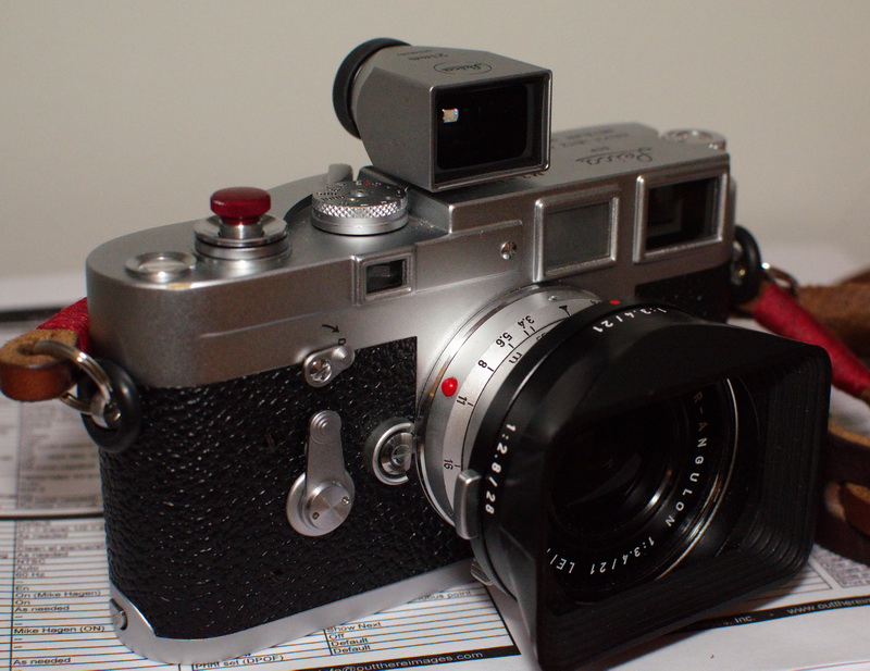

OK so I mostly shoot 50mm and I haven't noticed much framing error. Same with my Hexar AF but I do not compose so tightly. I know that a RF is not the best tool for careful framing but I do care to understand rangefinder limitations.
So I'm interested in going wider (28mm) but with an external viewfinder because I do not have the framelines (I have an M2/M3).
How "accurate" are these things? Are they just as accurate (or inaccurate) as in-camera frame lines?

from my experiences with original Leitz external viewfinders in 21, 35, 90 and 135 mm I'd say that they even more inaccurate than the internal frames. The rangefinders are of a very high manufacturing standard but every small misallignment in the accessory shoe leads to a more or less serious difference between the viwfinder image and negative. With the Leitz 21 mm and the Cosina/Voigtländer 25 mm viewfinders this is more a estimation than an accurate composition. No external viewfinder can fully take into account the parallax mistake and the variation of the image field caused by fokussing from infinity to close range.
Everybody who wants to compose exactly into the frame should use a SLR with 100 % viewing on the screen like a F 2 or F 3.
......No external viewfinder can fully take into account the parallax mistake and the variation of the image field caused by fokussing from infinity to close range.
Russar MR2 20mm viewfinder is parallax corrected from 1m to infinity. It is very precise in my experience and cover well up to 100%.
A few of the Canon models, VT, VIT, etc. did have a parallax correcting pin on the cold shoe, which would raise or lower as you moved the focus from either closest to infinity. Pretty spiffy design.
The best option is to get a body with 28mm frame lines, much more accurate than a 28mm external finder. Or going with wider lenses, such as 25mm or wider as its easier to use external finders on these lenses and get good results through zone focusing and the dof you get with the wider lenses.
If you dont want to drop to much cash, just estimate the frame lines with your M2. I used to do this quite a bit with my Canon VT, VITs. If you are familiar with the 28mm focal length its very easy to eyeball it from the edges of the 35mm lines.
The hot shoe on M cameras is offset from the lens centerline. External finders made by LEitz(now Leica) have an offset in the mount to properly align them over the lens centerline.
Any other type of finder will introduce a rotational offset in the picture.
So a proper Leica external finder for an M camera will work just fine.-Dick

FWIW, I think the entire idea of "accurate Viewfinder" is pretty much an oxymoron. You're just not going to get the accuracy that you Think you will with any accessory finder.
At 28mm it's usually very easy to get everything you need in the frame, the DOF is large, and the parallax is essentially negligible. Basically any 28mm lens will work just great with any 28mm finder - that's been my experience! At 50mm and longer, external finder lens match is a little more challenging, but I frequently use lenses to 135mm with no real problems.

Thank you for the advice. I no longer doubt the accuracy of the framelines. I mean, I never believed they were accurate to begin with but I've managed by leaving a bit of space around the framelines. I bother to have precise framing.
They might be less accurate, sure, but I think I can learn to see 28mm or just frame looser. I don't anticipate much, if any, tight composition at close distances anyways.
