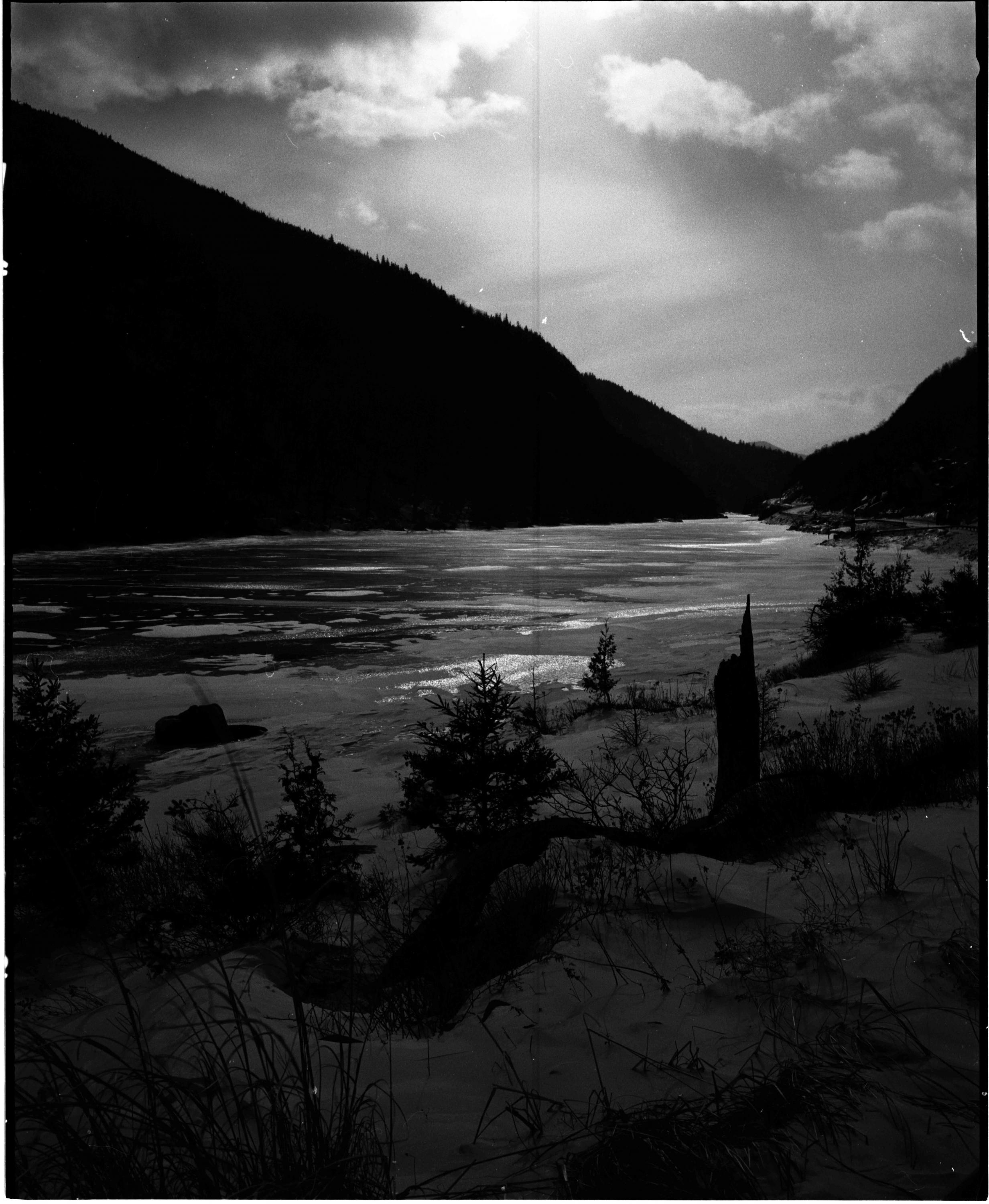

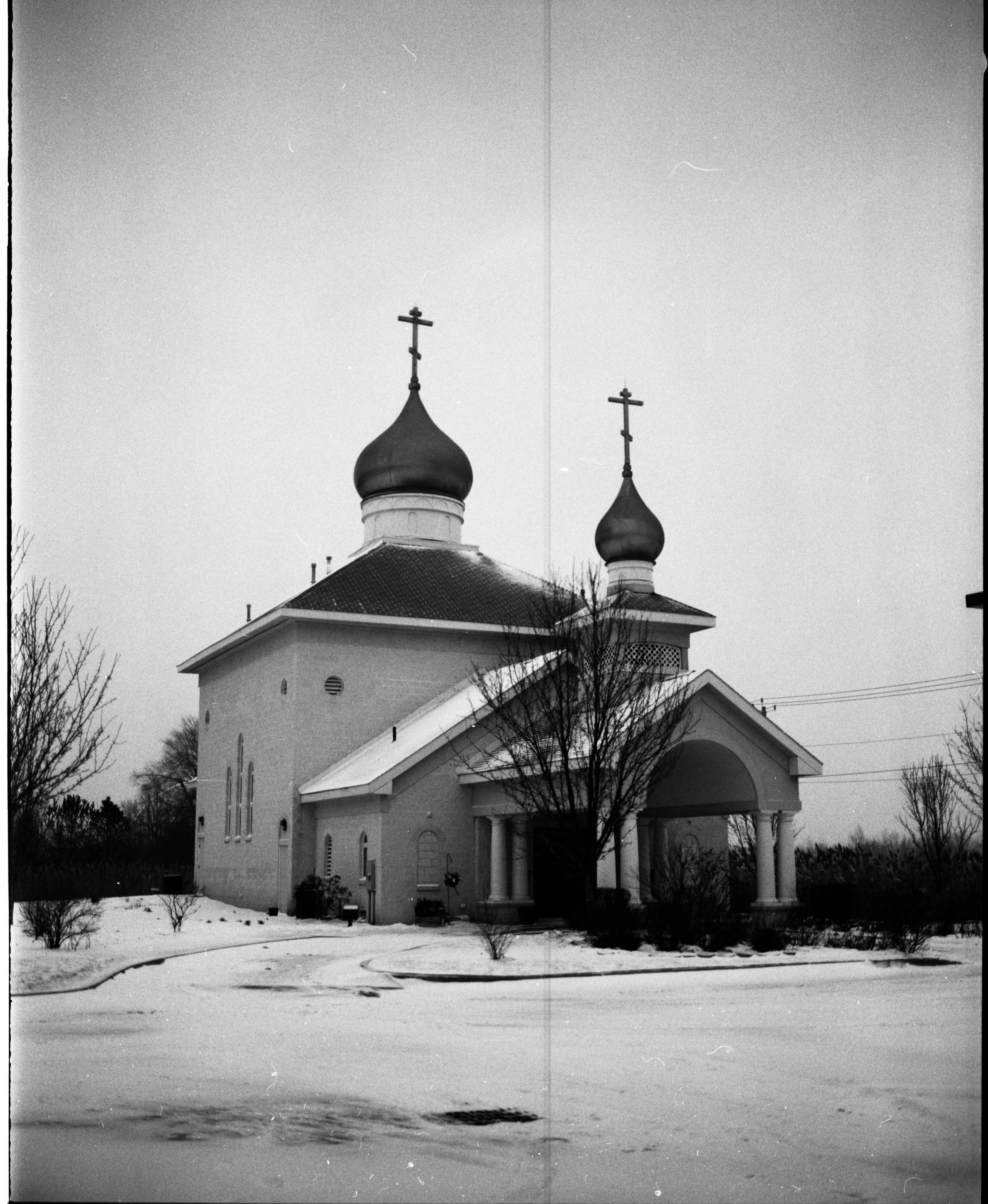

I have been having difficulties in being consistent with exposure.Last week I shot a role of 120 and used only a handheld meter (Sekonix Flashmate). I took an incident reading with the dome facing up, toward the sky. The resulting negatives were very dense (certainly couldn't read a newspaper through the highlights) and seemed overexposed. It was a terribly overcast day and the light very flat. Since I am not so experienced, I wonder if they are improperly exposed or if I make a mistake in development. I tried to be as exact as possible with the meter reading and development.
The film was HP5 shot at box speed and developed in Ilford Ilfosol 3 at a ratio of 1:9 for 6 minutes and 30 seconds according to the Massive Development Chart. I have attached two scans (disregard the line in the center?!?). The first is a frozen lake with a mountain that is somewhat backlit. The mountain lacks detail and the sky is blown out. The foreground and grasses seem ok. The second is a church in snow where the sky is blown out as well. The negative for the church is particularly dense. Please disregard the dust and bad scan. The scans don't reflect the negative I feel. I never scan negatives, but only do wet prints.
Do any of you have any ideas? (As a side note, I did a couple of interior shots using the same method and they turned out relatively well.) Thanks!

To add to what Rick A says above, your incident readings might have worked indoors because of relatively uniform light; if you have the meter in the same lighting conditions as the subject, the reading will be fine.
Your first negative, where "the mountain lacks detail and the sky is blown out"---that in itself says you can't fix the whole problem with exposure, because if you exposed less, the mountain would lack even more detail, and if you exposed more, the sky would still be blown out. You've got more dynamic range in the scene than the film could capture; because you were metering up towards the sky, your meter got a fairly high dose of light and you made a relatively low-EV exposure, which is why the ground is dark---but it was an overcast day, so there was a lot of dim area in the sky contributing to the reading, and the resulting exposure was still enough to make the hot spots in the sky blow out.
If you look at the bright part of the lake, where it isn't shaded by the mountains, it looks like you got a very good exposure for that part of the scene---which seems consistent with how you metered.
As for the shot of the church, I don't think it's so bad. The sky is featureless, but I see detail in the snow and the church itself looks well exposed. (Again, that makes sense for how you metered; if you were pointing the dome up at a fairly uniform sky, you were reading basically the same light that was falling on the church.) The usual rule of thumb is to add about a stop of exposure for snow, but in this case I think that might have been too much---anyway, IMHO that one isn't an exposure error, it's just a tough exposure problem and you came up with a reasonable solution.

It looks IMHO as a classical example of under-exposure and over-development. In fact, by taking an incident reading of the sky you very easily get too much light into the meter and that gives underexposure!. F. Ex. the mountain/lake photo, I would have turned my back to the subject and from there measured the incident light on a horzontal plane.
Ilfosol? I don't know. Maybe somebody else can tell more about it.

That said, Incident meter will measure the illumination. If you face the dome towards the sky then it means that you are measuring more or less the light falling on you rather than the subject.
On overcast day, incident metering is a bliss(second example) which lands you in proper exposure but then dome need to be pointed towards the camera.
For first example, I personally suggest to place the incident meter dome facing the camera in shade. If no shadow is found you can follow Rick A suggestion to simulate one.
Don't give up, I always got what I want from Incident metering.

Well, the one of the church is going to look dense, because it's basically a bunch of highlights with a church in the middle---and you may have overexposed a bit, which of course makes it denser. I don't think there's really any way to distinguish overexposure from overdevelopment by looking at a scan.
You said you wet-print---can you print through those dense highlights, or are they simply too bulletproof? I think that's your real answer. (We know there *is* some information in the snow in the church image, because the scanner got a little bit of texture there, but sometimes it's easier to get marginal detail out in a scan than optically.) I mean, if you can get the print you want, who cares if the negative looks funny?

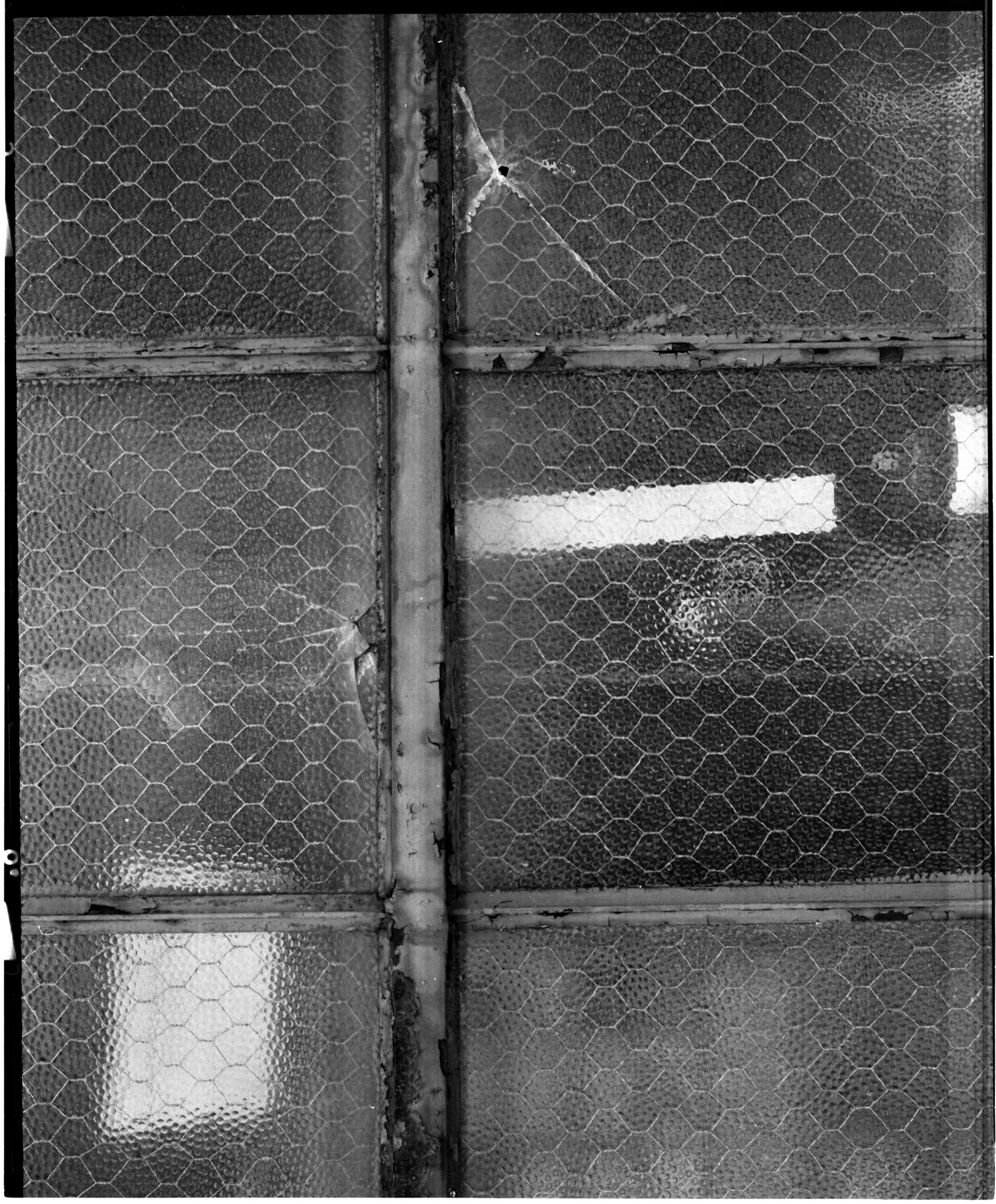

Perhaps I can pick your brain just a little more. I followed your directions. I shot a scene at meter value, then 1 and 2 stops over and 3 stops under. I found maximum black to be f11 at 21 seconds. I printed all the tests and the overexposed shots were still too dark. The scene probably is problematic. It is snowing here and the ground is covered with snow. The scene had a small mill stream with very dark stone walls and a brick barn in mid ground and trees and barn in the distance. It is high contrast. I was using a Mamiya 7 with HP5. Just for fun, I shot the same scene with a Sinar f1 large format. That was somewhat better, but still too broad a range of tone (snow with no texture and dark stone wall with no texture, but the stone barn looked great). Perhaps the scene is just too difficult.
In any case, my question might be, "What is the shadow I need to meter?" Perhaps it is rather subjective and there is no real answer. Maybe I am trying to meter too dark a shadow. How does one know what shadow to meter? I know that instructions always say to meter the shadow where you still want texture, but what exactly does that mean? Am I making any sense here?

  • Where did you meter in the scene to do your personal EI test? - perhaps you can post a scan
  • What was the person EI that you found to be nearest to what you want (i.e. your film is nominally 400 and your tests would have given you values of 400 | 200 |100 plus the three stops underexposed would have, probably, given you the negative that you used to do your black tests.
  • Did you follow these steps 'From the meter's reading close down the aperture by 2 stops or increase the shutter speed by two stops and then expose 6 frames at: the given exposure then +1 stop, +2 stops, -1 stop, -2 stops and -3 stops less than the meter has indicated' including stopping down 2 stops at the start?
By the way, snow should pose no great problems, if the snow has no texture then this would suggest to me that you are overdeveloping which should not be the case if you have followed stages outlined for the second testing phase to determine correct development time for achieving bright highlights with a trace of texture.
Finally, when people say "meter the shadow where you still want texture" they mean a dark area of the scene where they want to retain enough detail of the final print but which will also look pretty dark. In the example below, I metered the shadow on left-hand side of the tree as being an area I wanted dark but with shadow texture (the scan may vary on different monitors of course). At the bottom left of the scene is the edge of the curb which is black. I could of metered here but did not feel that it was important to achieve texture here as it is such a small area and the detail would not add anything to the image.

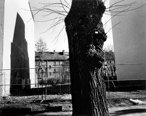

Get back to me so that I can advise further.

By the way, in the example image I just posted, the first tests to determine personal EI would be done by photographing close-up only the left shadow are of the tree and the second tests to test for correct developing time would be shot close-up on the bright white wall in the background.

Thanks for your response. I metered in a very dark window. When I look at your example, I am thinking that I metered in a far too dark selection. The scan doesn't look bad perhaps because the scanner software tries to make things right. However, when wet printing, using my maximum black, the print is almost completely black. Obviously I would have to expose the negative in my enlarger a way shorter time than my maximum black. The negative scan was two steps over my meter reading...in other words my box rate is 400 but in order to get what I did would be iso 100 and even that is way too dark.
Yes, I did follow the steps, closing down two stops then exposing the meter reading, two shots +1 and +2 then -1, -2 and -3.
I have not yet gotten to the experiment with development. That should be next I am sure, but I wanted to see if I could get a handle on exposure first.
