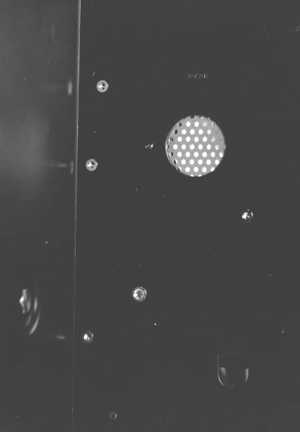

Here is what the inside of the color mod looks like when the brightness attenuator is switched on. It is thin metal plate with uniform holes across the opening to reduce the light evenly across the entire opening - so as not to bias any filtering inside the module. Hope this helps.
Bob

3. Thanks for the picture of the metal attenuator used on the color head. This is certainly one solution, taping such a piece of metal over the hole into the diffusion chamger.
