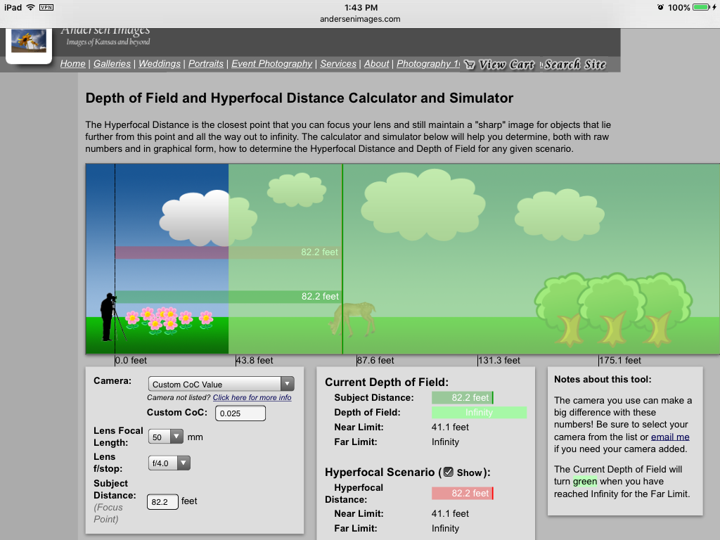

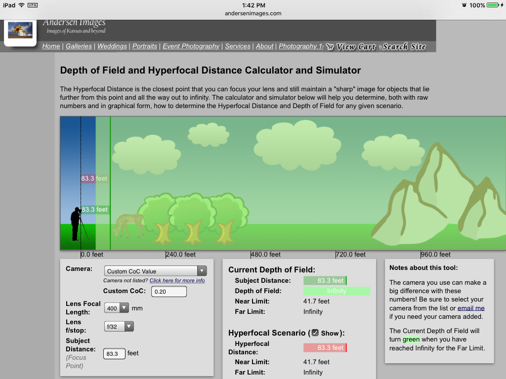

Consider this comparison of 35mm format (cropping to 4:5 aspect ratio) vs. 8x10 format, using the same film speed, to produce the same size print, with the same size CoCs after enlargement, with the same ratio of FL to format diagonal.
Note that the 35mm format will require 8x more enlargement than the 8x10 format to produce like-sized prints. That's why the maximum CoC diameter at the film plane, before enlargement, can be 8x larger for 8x10 format DoF calculations vs. the smaller CoC diameter that's required for 35mm format DoF calculations.
Above, the 8x10 camera, using a 400mm lens, must stop down to f/32 to secure DoF that ranges from about 41 ft. to Infinity.
Below, the 35mm camera, using a 50mm lens to achieve the same perspective (the same ratio of FL to post-crop format diagonal), but can shoot at f/4 instead of f/32, yielding identical results in the final print, but with shutter speeds that are 6 stops faster, with DoF again ranging from about 41 ft. to Infinity!
Screenshots were produced using the excellent utility at
http://www.andersenimages.com/tutorials/hyperfocal/
