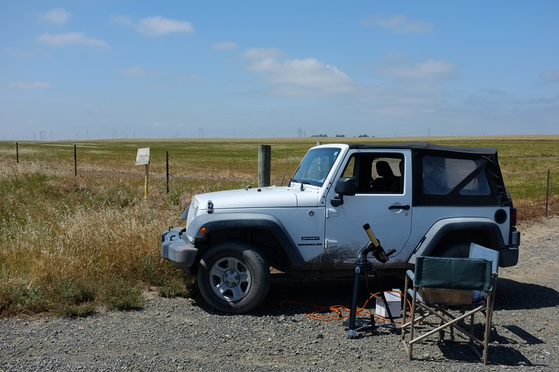

I've used the Baader film as well, on an old 500mm lens ( the kind with "donut-ring" shaped flare artifacts... ), I used the kind made for viewing with your eyes and it worked just fine ( they also have a kind for photography, which isn't safe to look through with your eyes ). During an annular eclipse, I cheated and stuck it on a digital camera first to get an idea of the exposure, then swapped it back to the F3 ( the F3 was WAY better.... couldn't get the focus right on the digital camera... at least not without taking more time than I wanted from viewing the eclipse myself ). Can't remember what the exposure was but something like F/8 and 1/8s or maybe 1/4s. As others said.. be hyper-paranoid-careful about pinholes and always inspect the filter carefully by holding it up to sunlight and checking. With this kind of filter you can see sunspots and maybe a few filaments and plages, but not other features like spicules and prominences ( which might be what you are thinking of when you think of the sun's surface ) I've also got a small solar telescope with a hydrogen-alpha filter. Through the eyepiece photos are possible but difficult due to the short eye relief. I've only used digital with the telescope.
I watched the transit of Mercury with it a few years ago, and the transit of Venus before that
Transit of Mercury
par Ned, on ipernity
These telescopes made by Coronado are not terribly expensive and the views of the sun are incredible. We've been in the solar minimum for a few years now and it's not very active these days. There is another transit of Mercury coming up very soon in November. The next one won't be until 2032.
