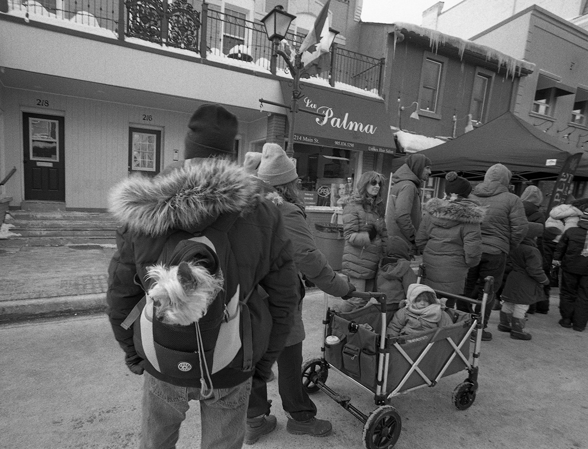

Follow up on this. I developed in HC110 dil 1:63 for 8min @21 deg C. The result is acceptable and printable
