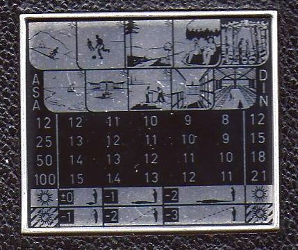

Light under the redwoods I find to be too complex for guessing -- but I am always amazed at the consistency of light under the open sky.
So whatever floats your boat and helps your understanding of the light. I have always liked this chart on the back of my first Roleiflex...
Edited to add: By 'complex' I mean that under the same general lighting conditions, the deepest shadows I want detail in can vary by several stops from scene to scene, while the mid-tones and highlights stay about the same.
That is a cool chart. I like the lengthening shadows on the figures, which makes sense.
