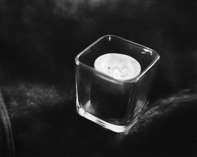

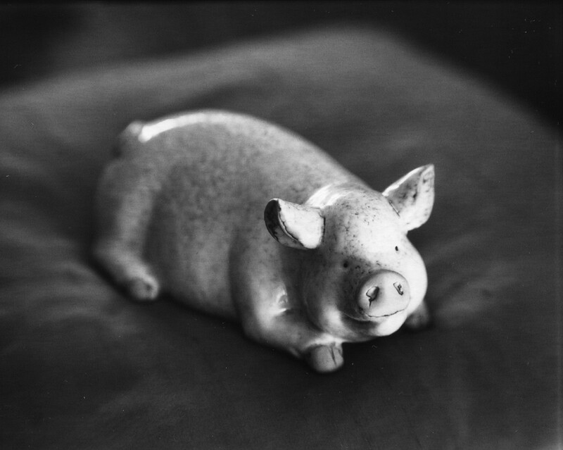

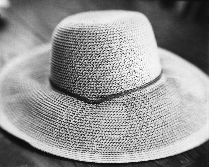

Yesterday the itch was strong enough such that it required satiating by exposing a number of Harman direct positives in my Speed Graphic, using a 150mm binocular lens improvised as a camera lens, stopped down to 20mm aperture. Lighting was indirect north daylight, absent any artificial illumination.
All images preflashed and developed in Ilford PQ Universal paper developer for 2 minutes at 1+15 dilution.
Hat: (1:00 minute exposure)
Hat001a by jvcabacus, on Flickr
Pig: (45 second exposure)
Pig001a by jvcabacus, on Flickr
Candle: (1:00 minute exposure)
Candle001 by jvcabacus, on Flickr
