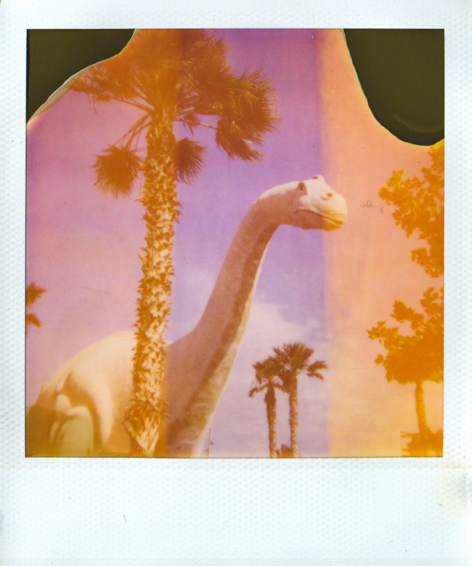

If you are using expired 600, one thing that helped a *bit* was to take pictures with the self timer, so I could use both my thumbs and forefingers to squeeze where the film exits, which helped spread the chemicals better, unless of course they are completely dried out
