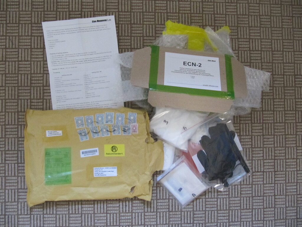

well in my case I have received the ECN-2 kit from Moskva today. No problem, usual fast processing as VOEC through incoming norwegian customs. Not opened/inspected.
It comes with mixing instructions and even a pair of gloves :smile:.
