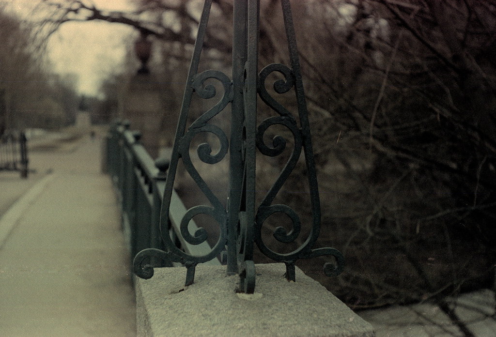

I use V3,500T that I bought from an APUG user. Works great although the REMJET is a pain. I'm not sure how out of date it was. It also has a great smell that other films don't have.
Cholentpot
Oct 26, 2015
6,670
Cholentpot, nice rose. What is your process for removing remjet?
Baking Soda [Not Washing Soda] About a tablespoon at developing temps before developing. Into tank full of 102 degree water and shake it hard for 30 seconds. full and dump until clear. After blix before stab take out of reel, hang, and run a glasses cleaning cloth or something soft down the film soak in photo flow water and wipe until cloth is clear. Stab and done.
Kodak films have a much tougher coating to remove than Fuji. It's very stubborn. Fuji's washes right off.
Cholentpot
Oct 26, 2015
6,670
Thanks! Do you reload the film on the reel to go into the stabilizer bath? And when you say "fill and dump until clear", are you refilling with baking soda solution, or plain water? I appreciate your comments.
I reload onto the reel while wet and put back into the Patterson tank and pour in the stab, but I guess if you can't, you can stab the film anyway you'd like.
I'm leaving the soda in with agitation for 30 seconds to a minute. After I rise till clear with straight water.
The film must be scrubbed somehow or another after the blix. Some people wash it under running water using their fingers to rub off the REM. I find that the only way to get everything off is with a soft cleaning rag or a sponge of some sort.
The film performs very well. I started rating it at about 600 and because I scan I ditched the filter. I color correct in post. This shot was at 800 and was not pushed in development.
This was @ 400, no filter no push or pull
