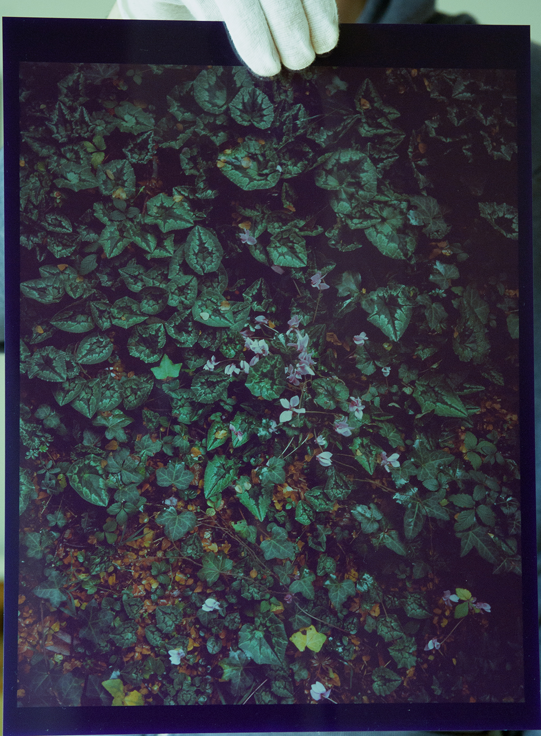

Hi all,
First post here, however I have frequented these forums over the years and always found the conversations to be a reliable source of knowledge, and I hope this post is appropriate.
I have recently come into possession of a bunch of Ilfochrome CLM.1K paper, and a single box of P30.2 concentrate(2L of working solution), not enough to reliably process the amount of paper I have even at the best of times. I have no experience printing ciba/ilfochrome, as it's a bit before my time, and did not expect the results to be usable anyway, but was optimistic and have had one session with them.
I have found the results to be surprising all things considered, and my main question is this. Is there any way I can extend the life of the bleach and/or replenish it without more Ilford P30 chemistry? Among a few inconsistencies in my results, the one I have not been able to get past is overall fairly dark prints, I have not been able to yield any whites and can only produce dull highlights which are a far cry from what this material was capable of. Increasing the temperature of the processor (Ilford CAP40) from 34 to 37 degrees C improved this slightly, and changing the fix for fresh rapid fixer also improved the overall brightness of the prints slightly.
Aside from this, I have struggled with the colour balance a bit, but I can live with that as I can work creatively with it. I know some of you might think I'm wasting my time here, but despite these issues, they are still beautiful prints, and if any of you have some suggestions to improve them and utilize more paper with the limited amount of chemistry I have left, it would be greatly appreciated!
Thanks
Jun 7, 2005
800
Torino, Italy
Alas Cibachrome/Ilfochrome is not forgotten, but gone nonetheless. It will be never mourned enough as every other colour print looks dull by comparison, not even to mention the digital garbage to which newbies are adapted.
To the best of my knowledge, when "paper" and/or chemicals are expired, there's absolutely nothing to do. All prints will come out weak and with terrible colour casts, which is why I completely quit buying old stocks at a point in time, and gave my few remaining stocks for free to a young fellow here who had in mind to make experiments.
I really have to praise the pictures you show here: these are by far the most beautiful pictures I've ever seen done with expired Cibachrome sets. The wise choice of subjects that are nearly monochromatic by nature and of slides that would benefit by a very low contrast print is possibly the key to get these images that are not "technically" perfect but still pleasing to look at.

Thanks Marco, your scenario with the young fellow sounds very similar to how I came to be in possession of these materials. You are right about the subject choice, I had ambitions to print a series of landscapes and quickly gave that up after a few test strips, choosing more simple subjects and colours. I suppose I will have another session and see what more I can squeeze out. I have to say I am pleased to be able to have had the opportunity to print some of my slides none the less!
