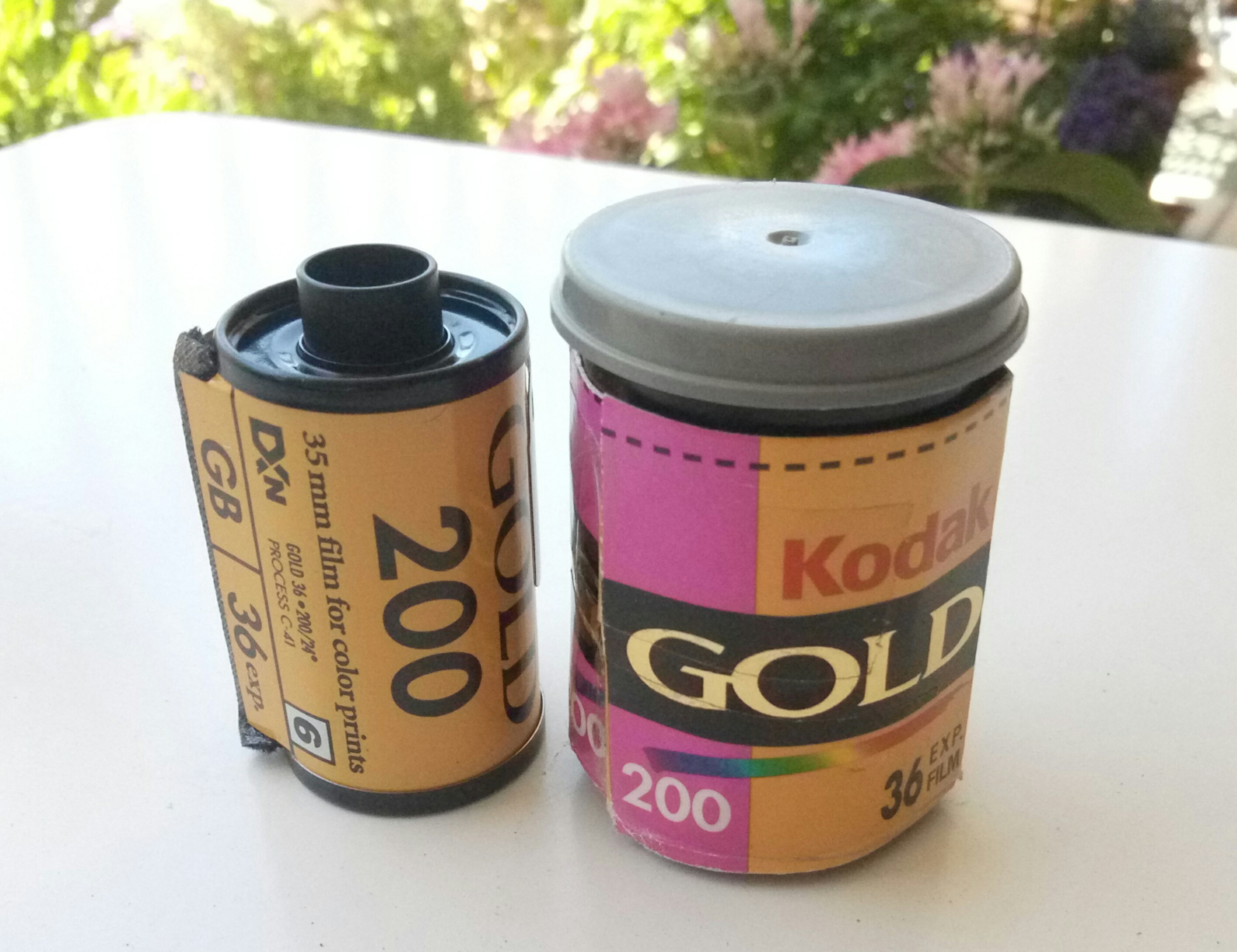

I recently found an roll of Gold 200 I'd like to shoot, however the box has been cut up and wrapped around the canister, no expiry date anymore.. The only thing I know it's that it quite surely is expired, I don't know by how long though.
I thought someone in here would surely be able to tell me from when to when they used this print on the box, to help me narrow or down a little?
I'd also be happy for any suggestions at what did I should shoot it at, I've never shot excited film before. I'm pretty sure it has never been stored correctly.
I don't care how 'bad' or 'interesting' it will turn out, I'd just be happy to get some kind of an image. :smile:

The black film canister and older Kodak logo date it at least a decade old. IMHO more likely pre 2005.

Does the number "6" on the canister have any significance (I've noticed these numbers before, but never known what they meant ) ?
Yeah, I thought similar but I was pretty unsure as <12 year old me didn't care much about what film went in to cameras. :smile:
How would you suggest I should rate it?
Fairly tightly wound round. It's there. :smile:
SN is 412504 is that might be any indication of age too?
