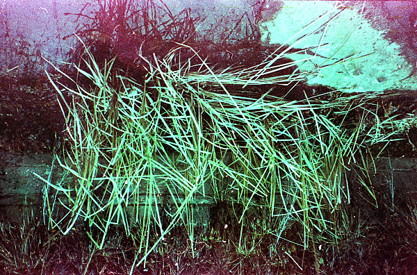

It depends on storage, but one might expect loss of speed (particularly in the shadows), color shifts, and dense negatives from base fog. Maybe overexpose a bit, but expect defects.
This shot was from a roll of film (400 speed kodak) already loaded in a camera I had purchased and developed in standard c-41 chemistry.

The frames I posted were exposed via a point & shoot camera, so it used the ISO encoded on the canister (400). I forget the specific filmstock but the expiration date was ca. '92 or so. Since you have more than one roll you can try a range of overexposures. It may be expired film has a harder time with high-contrast scenes.
ISO 100 is a good estimate.

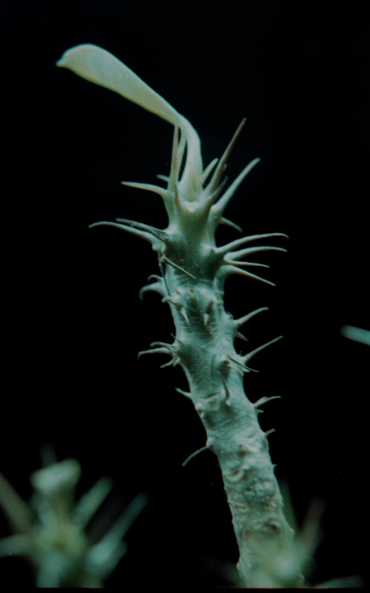

In my humble personal experience, the best way to develop these films is. You must set the ISO button to 64. I had the same 2003 production class.
- Stay away from indoor photography, the attached photo was filmed in this movie using artificial lighting and a black background with a macro lens.

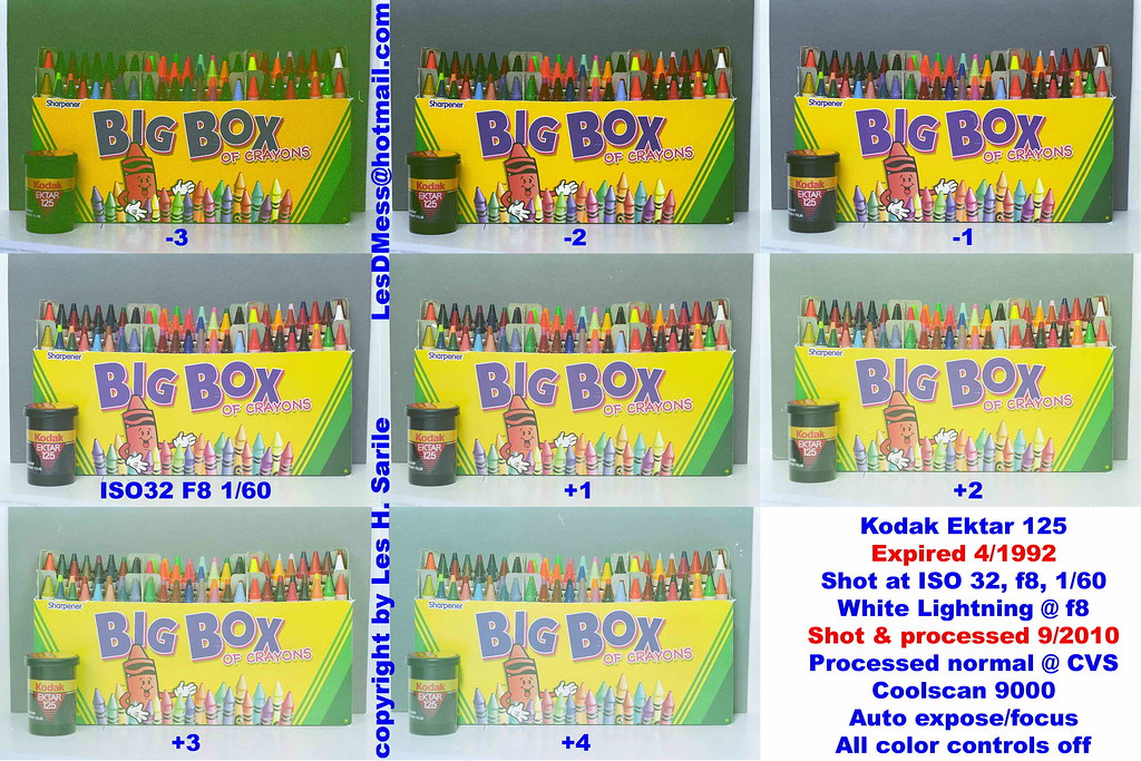

Can also depend on storage conditions.
This first one is Kodak Ektar 125 expired 4/1992 and shot/processed 9/2010. In original individual package and Was kept out on a covered driveway in very hot and humid Atlanta for unknown but many years. I setup my camera as an ISO32 and processed at box speed.
Kodak Ektar 125-1_03 by Les DMess, on Flickr
As normal as my fully automatic scans are of this, the mini lab scan colors are far from normal.

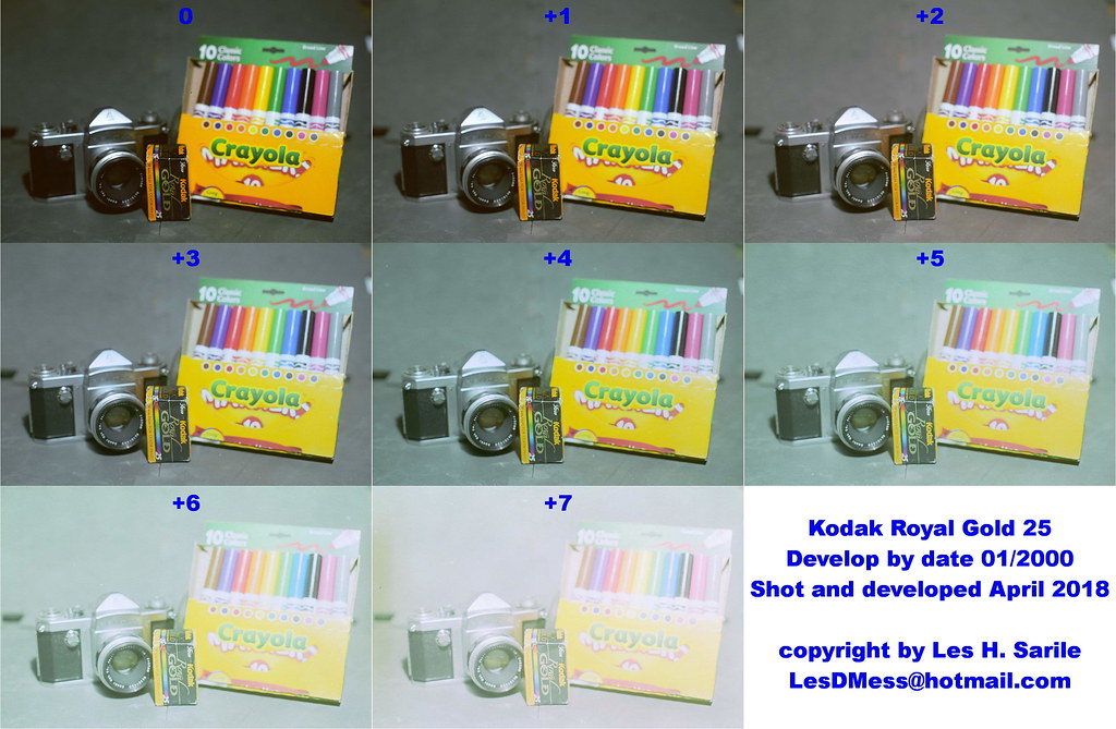

This next one was Kodak Royal Gold 25 expired 1/2000 and shot/processed 4/2018. Was refrigerated the whole time. I setup my camera as ISO25 and processed at box speed. Looks very normal.
Kodak Royal Gold 25 by Les DMess, on Flickr
BTW, with a minimal amount of post work, I can make +7 overexposed look very normal.
