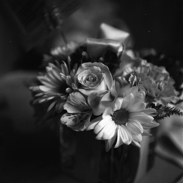

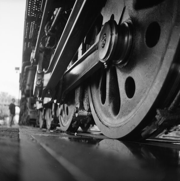

Here are some shots I did a few months ago. This is Plus-X Pan (1987) in fresh D-76.
What do you guys think?

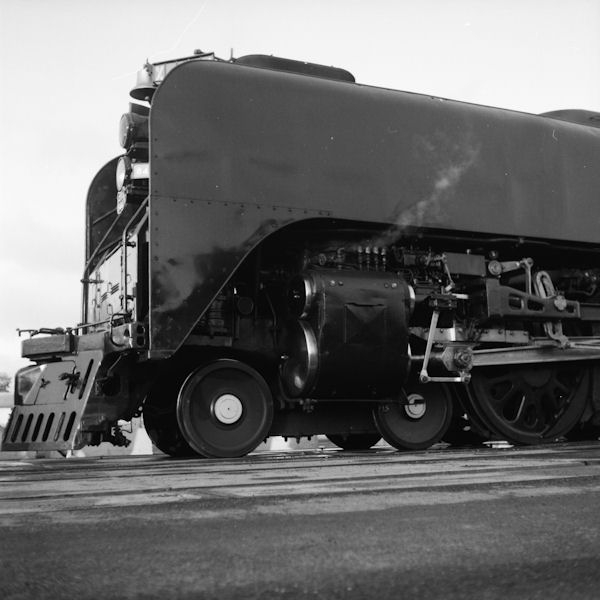

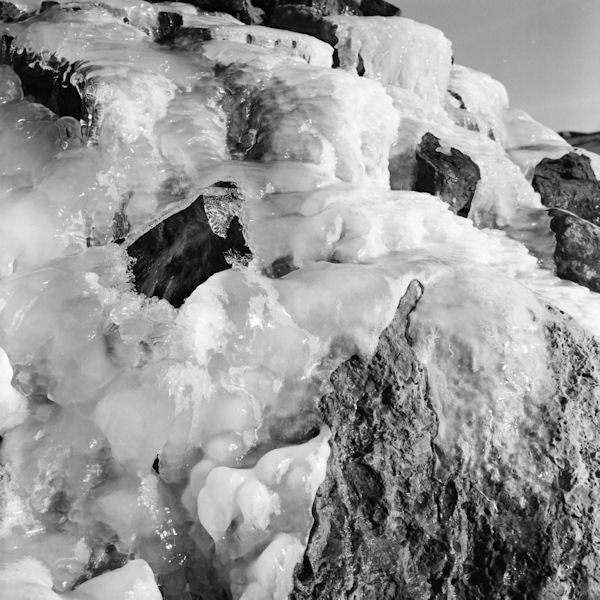

Results
I developed a couple of rolls of Plus-X Pan expired 1996 (Frozen) using the regular development with Rodinal 1:50
Tell me what you think.
For the older rolls I am thinking of buying Benzotriazole to add to the developer
How much would I add to Rodinal 1:50
