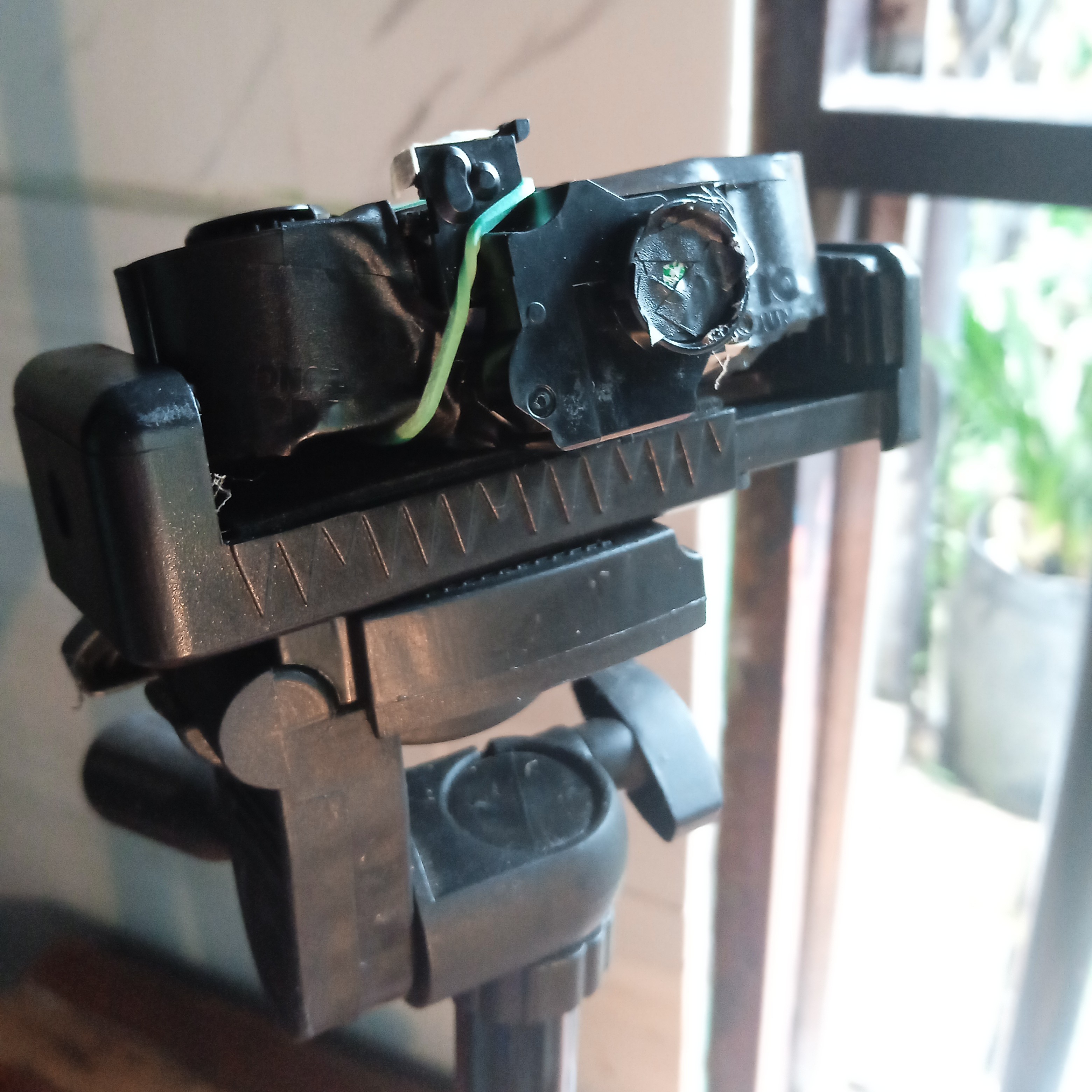

This is my 110mm Pinhole camera, which is also my first experience with Pinhole photography. I'd like to use them but I'm afraid of exposure times. The calculations are complex but could anyone give me any tips? The 110 Film i am using has expired in 1991 and my pinhole diameter is 0.2 mm (F/number 174 - Focal Length 40). What could be the best Exposure Time for this 110mm Pinhole camera?
My sincere thanks for any help!

As you don't provide that information, let me assume the film was 200ISO (adjust according to the actual box speed). Due to age assume the effective ISO is now 100.
  • You have a meter. Meter the scene (not appropriate to start a discussion about subtleties). What speed for an f-number somewhere between f/16 and f/22 (target f/17.4). Multiply that time by 100.
  • You don't have a meter. Apply "Sunny 11" (yes, I mean f/11) for 100 ISO film, i.e. sunny or hazy 1/100 f/11, cloudy bright 1/50 f/11, cloudy or open shadow under sunny sky 1/25 f/11 (and yes I vary the speed rather than the f-stop, easier for what follows). Multiply the time by 250 (174/11)^2.

The numbers do not fit. Pinhole diameter 0.2 and "focal length" 40 results in f/200. Marginally significant for exposure calculation. But, since there are unknown unknowns, it is best not to start with a systematic error.
The hole diameter could be 0.23 - rounded to 0.2 - but used to calculate f174.

Pinhole calculations are not complex at all, and exposure is the same as normal photography. The simple Sunny f16 rule applies -- all you do is adjust from f16 to whatever your f-stop actually is. You'll need about a 2 second exposure with ISO 100 film at f200.
http://www.subclub.org/fujinon/pinhole.htm
