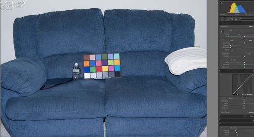

I just did this test so you have comparative information...
  • Flash equipment: Metz 54MZ-4
  • Target: Macbeth Color Checker placed on a sofa which measures -0.6EV compared to 18% grey card and which dominates the frame.
  • Lens FL set to 'normal' AOV (30mm), flash coverage angle set automatically to 28mm
  • Ambient light: ISO 400, 1/15 f/2.8
  • Camera set to ISO 400 1/100 f/2.8
  • Minolta Autometer Vf Flashmeter measurement of Auto mode (flash photosensor) as a 'control' measurement: ISO 400, 1/100 f/2.0 +0.5EV
ETTL mode shot, as comparative 'control' shot.
The Auto mode photosensor flash shot
The two histograms for the above shots
Conclusion: Virtually same results between ETTL vs. flash Auto mode.
I have always found Metz photosensor mode to be accurate and reliable, given the inherent limitations of a fixed photosensor AOV and the variable of background and subject brightness. I have, in the past, relied upon 135 and medium format film cameras with TTL capabilities for increased accuracy flash exposure because of the flash AOV being same as the lens on the camera. This comparison shows that my Metz Auto mode flash is equivalent to what I would get with digital camera ETTL, and the flashmeter measured exposure was within 0.5EV of the lens aperture.
