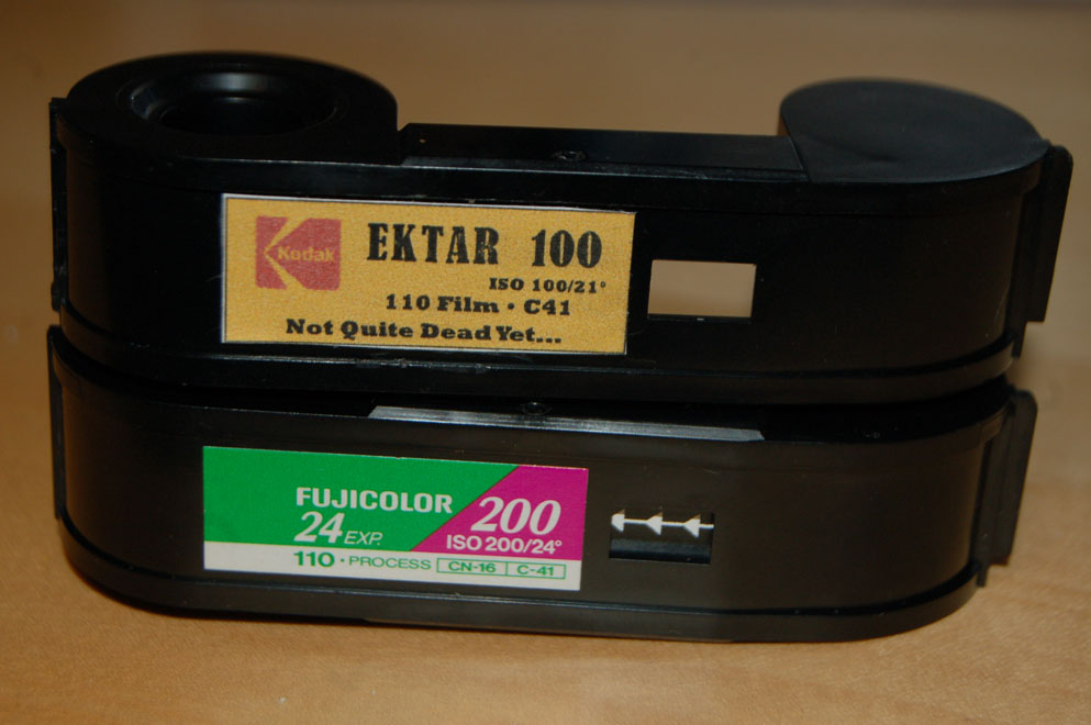

My idea has been to reload the cartridges with Ektar 100 and various other slow speed films. The Minolta SLR has exposure control to achieve full stops between ASA 25 and 1600. I'm not sure how sharp the lens is; I know ektar generally out resolves lenses. It should be fun. With loading my own film I will achieve a larger frame area as well despite the poorer frame spacing using the Minolta. I look forward to having some fun.
Some of you may appreciate this waste of time:
