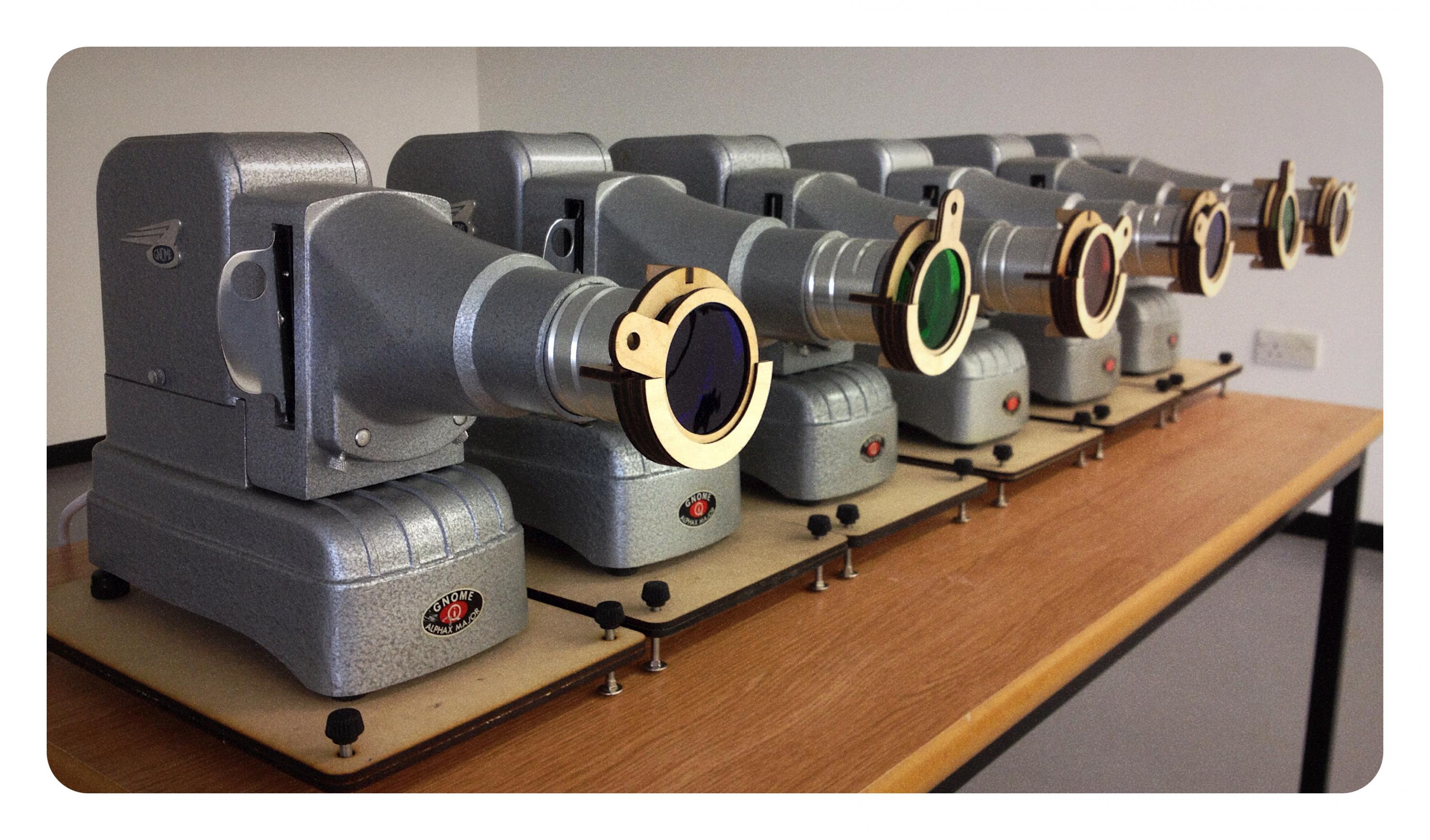

The 6x6 film frames go straight into glass slide mounts, which are then projected by three beautiful Gnome Alphax projectors (sourcing matching examples has proved to be another challenge). Registration is orchestrated by home made levelling plates that sit under each projector, and reworked slide carriers that use magnets to align the slide within the projector.
Finally, a home made filter holder clips to the front of each projector lens, allowing for the addition of various shades and densities of red, green and blue filters at the projection stage; this in turn makes it possible to mix the overall colour of the final image in front of the viewer, as a kind of performance / educational art piece.

I've just managed to get another set of three projectors together too, so I'm excited by the prospect of having all six beaming out a diptych that measures a couple of meters across.
