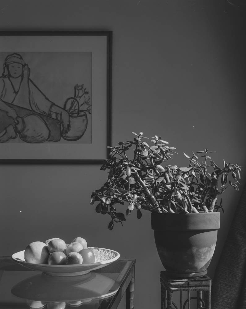

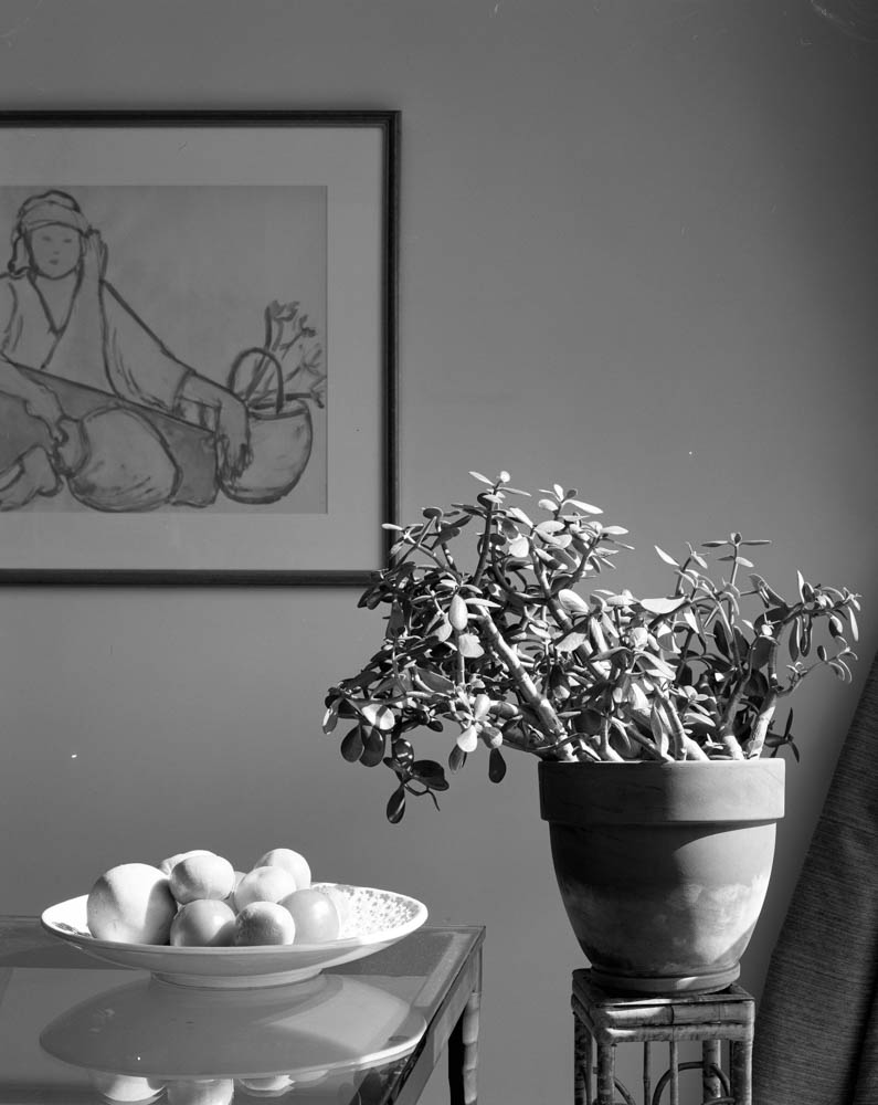

Funny that you mention HP5+ in DD-X. That's what I've been experimenting on these days. Found that with contrasty scenes, shot at box speed with normal development, contrast becomes really strong. I really don't see it as "grey", as others have mentioned.
First image is the original. Highlights are really blown. Part of it might be the scan (not under my control, done by lab).
Exposure toned down and contrast toned way down in Lightroom (image two) show that the information is well recorded.
Some might like it, but it's not to my taste, even though the negatives would be quite workable in the darkroom.
Shot on 4x5 (Linhof Technika), 135mm lens @ f/22.
