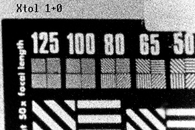

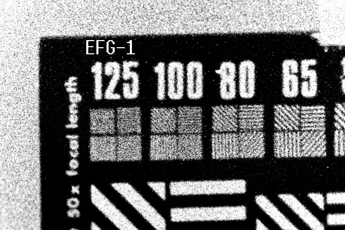

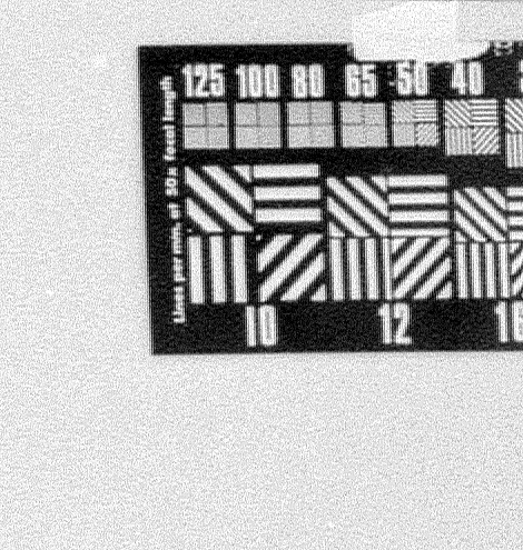

EFG-1:
Metol............................10g
Sodium Ascorbate............50g
Borax..............................9g
Water to..........................1L
pH~6.5
Wear gloves,some people develop an allergic reaction to impurities in metol.
Develop Ilford Delta 100 20m 20C
A high concentration of the developing agents means EFG-1 works at low pH,reducing swelling of the emulsion and consequent grain.

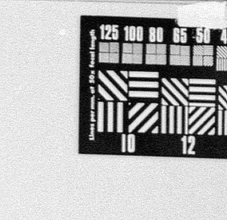

It gives slightly more grain than Xtol 1+0,with higher acutance,see attached photomicrogaphs (btw,resolution~80 lppm on negative).See the gray area round the black card for grain comparison.
This is probably the finest grain obtainable from ascorbate without sulfite.
It might be possible to get finer grain by adding,say,80g/L sodium sulfite and adjusting the pH with Borax and/or Boric Acid to keep it below ~7.
I wonder if there are any comments on this approach, thanks.

Can you show an H&D curve of the two examples above? I really don't see grain that is that much finer, but I do seem to see a difference in contrast.

To me, EFG-1 looks a bit more grainy but sharper than Xtol. But the sharpness could be an illusion if the contrast is higher. It is very hard to tell with these high contrast images. For grain and sharpness comparisons, images have to be developed to the same contrast. I echo PE's request for curves.

Scientifically,I have to answer "don't know" if metol gives finer grain than phenidone.
I used metol as it is used in the fine grain developers Microdol-X and Perceptol I believe.
PE, nworth,
I don't have H&D curves,agree there is a difference in contrast.
However, IMO the photomicrographs show the grain with EFG-1 is not significantly less than that with Xtol 1+0.
Can metol-ascorbate give finer grain than Xtol if sulfite is added?
No metol-hydroquinone-sulfite fine grain developer exists I believe.
If lowering the pH for MQ does not work, why should it work for MA?
Perhaps ascorbate does not give the hydroquinone effect,infectious development.

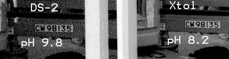

My result, I only have the scans attached, is that the metol-ascorbate developer DS-2, pH~9.8 gives more grain than Xtol, pH~8.2.
The DS-2 scan appears to have a higher density and contrast than the Xtol scan. Comparing two developers really requires that density and contrast must be the same.

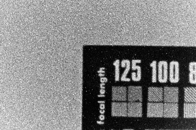

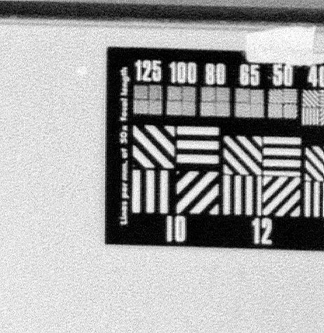

Please see attached scans of Ilford Delta 100 developed in EFG-1, EFG-1 + 30g/L sodium chloride, Xtol 1+0,and Perceptol 1+0.(My scanner only resolves ~45 lppm, the scans are of 0.1 in square sections of negative.)
EFG-1 gives probably about the finest grain that can be obtained by increasing the developer concentration and reducing the pH. IMO the scans show no detectable difference in grain with Xtol or with 30g/L sodium chloride addition.Perceptol gives the finest grain of the four.

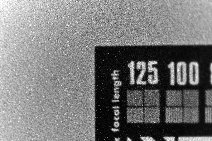

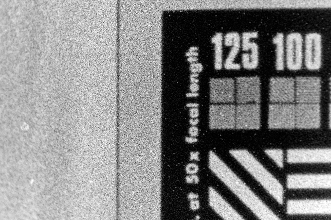

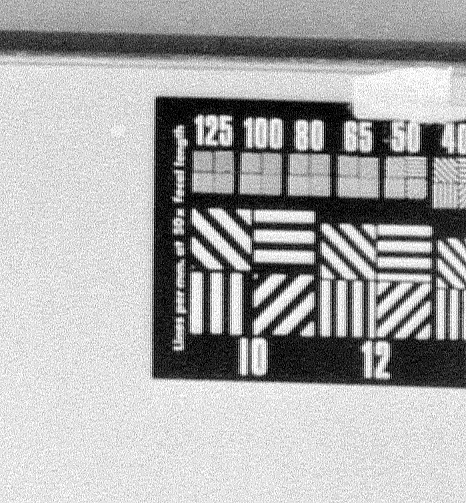

Here are higher resolution photomicrographs.
The apparent sharpness depends on how well these are focussed but IMO the probability is that EFG-1 has higher acutance than Xtol.The effect of NaCl is still hard to see but it may slightly reduce grain,possibly to Xtol levels.
I don't think using high concentration of metol and ascorbate and reducing the pH, in absence of sulfite, is going to provide super fine grain like Perceptol.
