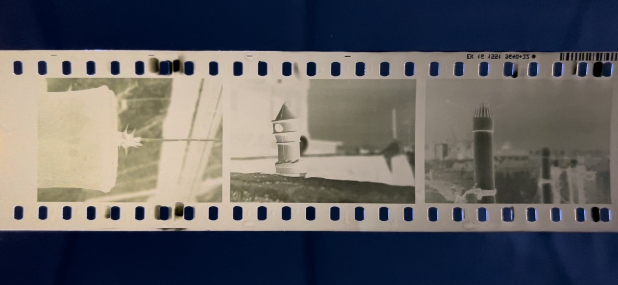

Hi everyone!
Novice here. I’ve been lurking for a while now and thought It’s time that I start posting and
asking for constructive feedback. 😊
Please share your thoughts.
Thanks in advance! 🙏🏽
Oz
[Snapshot of negatives taken with iPhone]
[Positive image Inverted quickly using Lightroom app]
Objective: trying to test if an inverted, color motion picture film, has the potential to behave in a way similar to having in-camera ND and orange filters, due to light being forced to pass through the remjet layer and the orange film base before hitting the light-sensitive layer of the film.
Film: I don’t know much about its origin other than the following: it’s a 200 ISO Kodak motion picture film that was repurposed as B&W negative film by a local lab. It has the code: “EK 16 1551 9638” printed on it, but I couldn’t find anything online about it.
For normal processing, the lab recommended using a simple baking soda solution to soften the remjet before developing it in B&W chemistry, then removing the remaining remjet manually while rinsing the film at the end.
Exposure: I reloaded a small clipping from the film into a spare canister (with remjet facing the lens) and shot a few frames using a Nikon F90x in broad-daylight at estimated ISO 6 (5 stops overexposure).
Process: I followed the times and instructions provided by the lab to establish a baseline. Pre-soaked it for 3 minutes, sat it in baking soda bath for another 3 minutes, then developed it for 20 minutes in D76 stock solution @ roughly 20°C. Agitation was continuous for the first minute then 5 light inversions every 5 minutes, stopped with water then fixed as usual. Remaining remjet was carefully removed underwater using my thumbs during the final rinse.
I Haven’t had a chance to try printing yet but I plan on doing so later tonight. 🤞🏽 Will post a follow up as soon as I can.

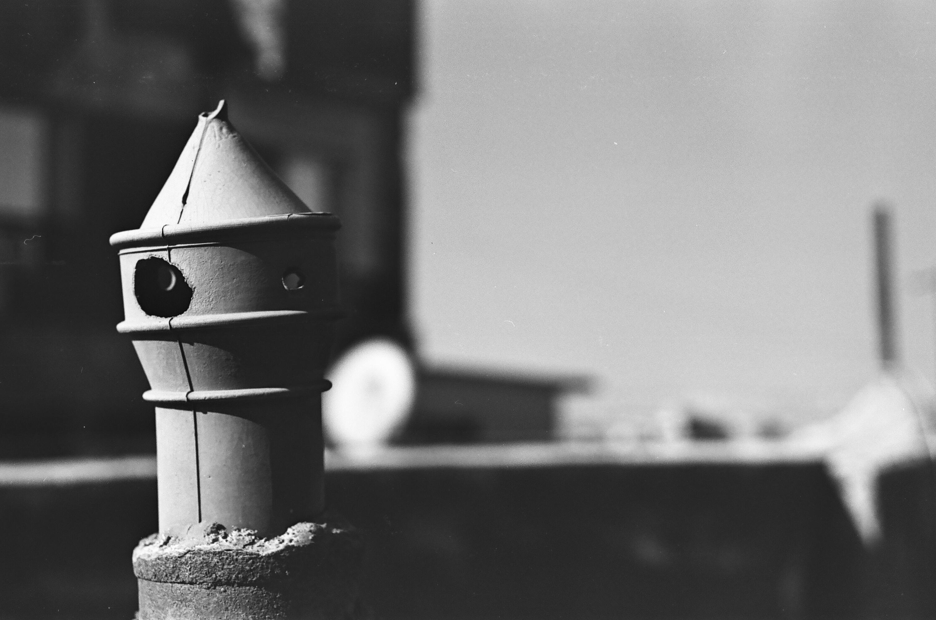

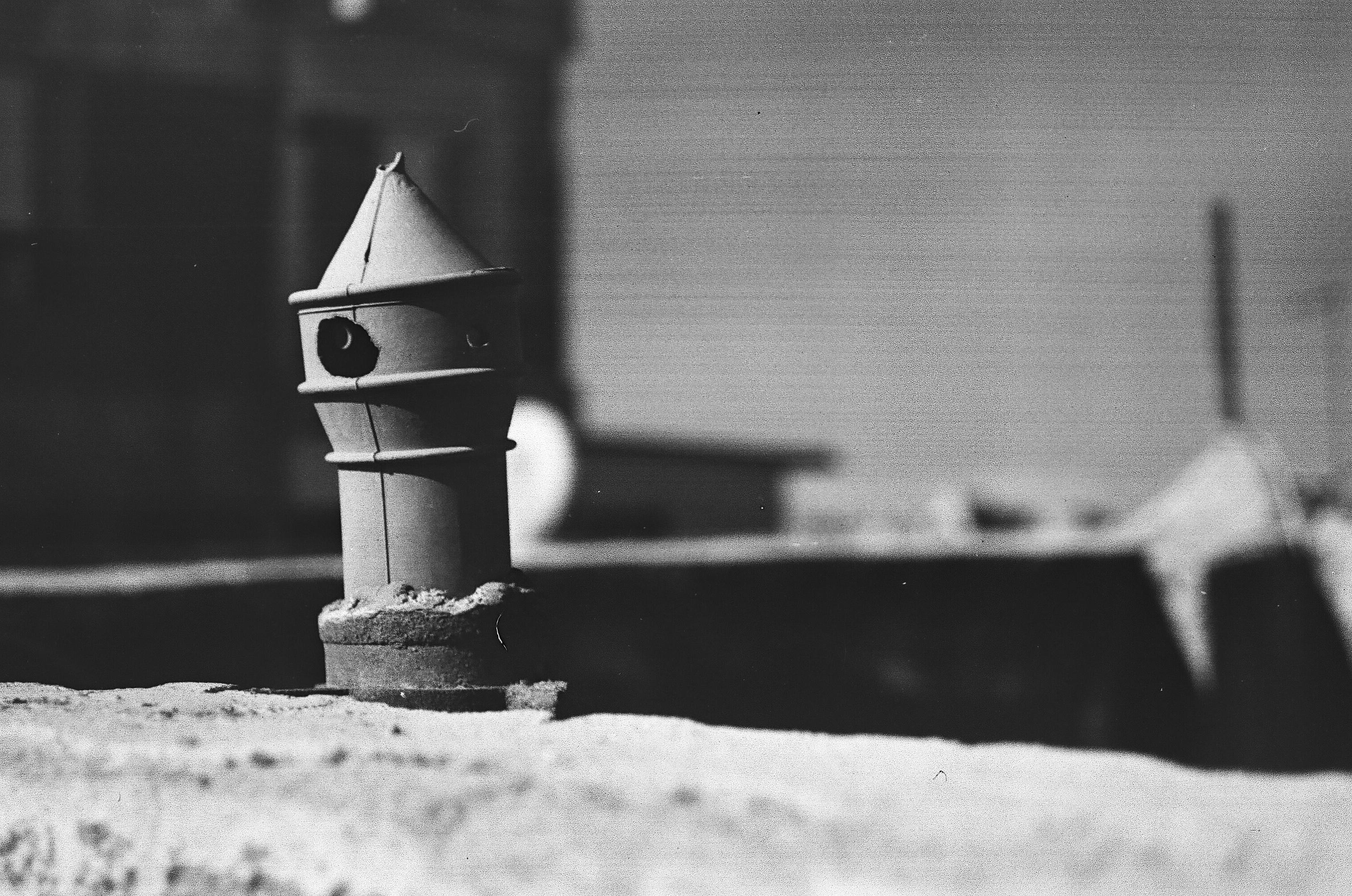

The film, shot properly, is fairly high contrast. Here's an inverted snapshot of a clipping from the same film, shot regularly at ISO: 200 and developed exactly the same as the clipping that was shot through remjet.
Quite interesting; I've never tried processing this film B&W. I can see how it could come out high contrast; it's a matter of giving enough development. Which is necessary if it's rated at EI200 and it's in reality a 50-speed film.
I still think the choice of selling this particular film as a B&W stock is very odd. If people can obtain 50D in Egypt, surely they could also get their hands on Double-X, which is a proper B&W, actual 200-speed film with no messy remjet either.

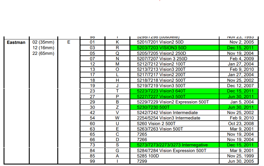

FWIW EK is the code for : EK 5201 colour negative
KODAK VISION2 50D Color negative Film 5201 / 7201 (EK)
Made 2005 to 2012.

Yes, I had forgotten about that emulsion code table. Anyway, the other marking is more comfortable and I'm used to it :smile:
There's now some logic to why this film was offered in black and white - it probably isn't very suitable for color anymore. Hence its more affordable price. Which perhaps reduces the likelihood of a cheap 5222.
Two stops of push would really lift the contrast, but given the age, I'm not too sure what's going on with the midtones...

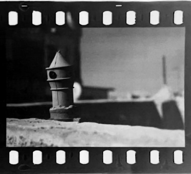

[update: replaced the bad quality snapshots with a better one of the dry test-print in sunlight].

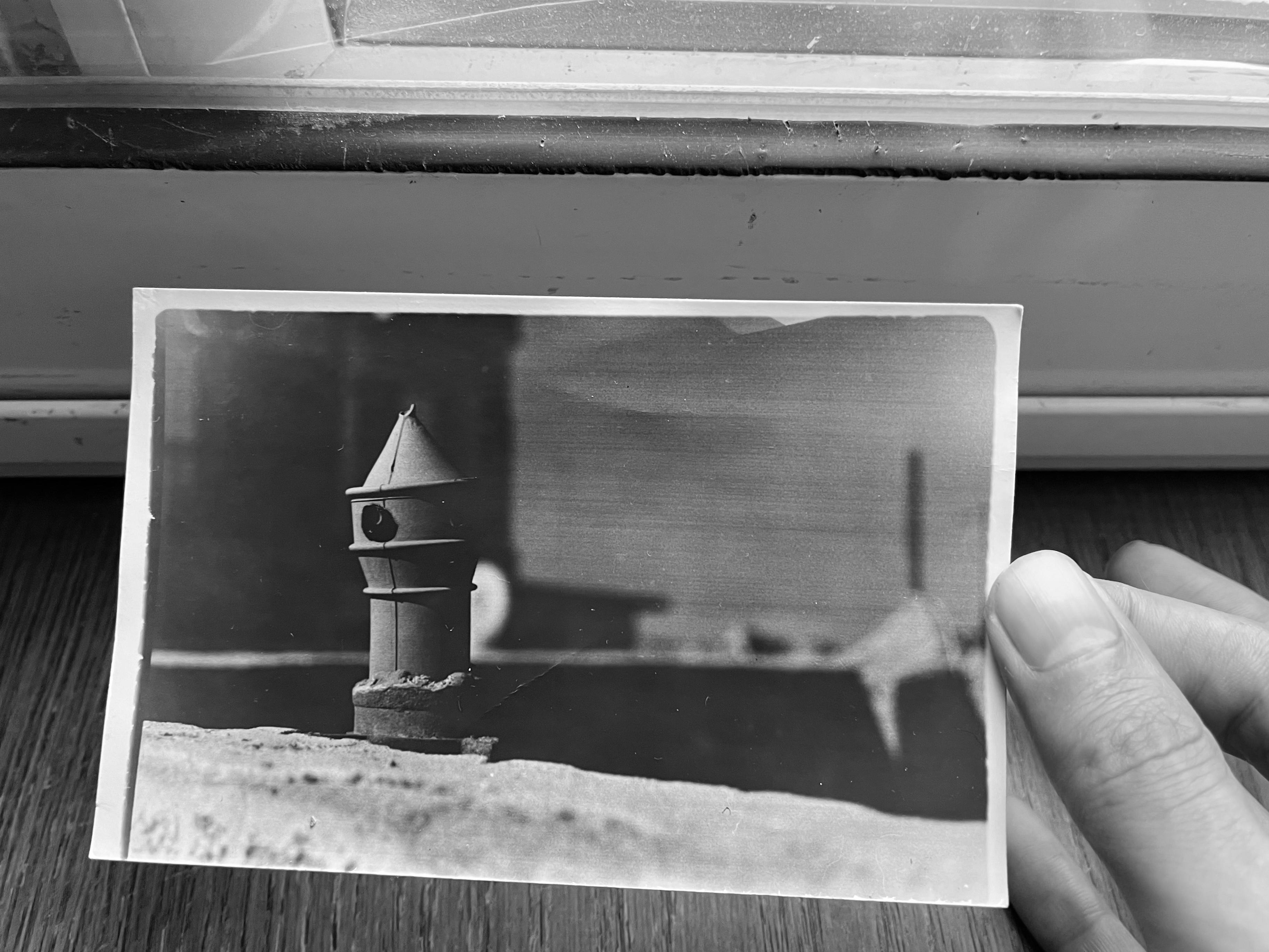

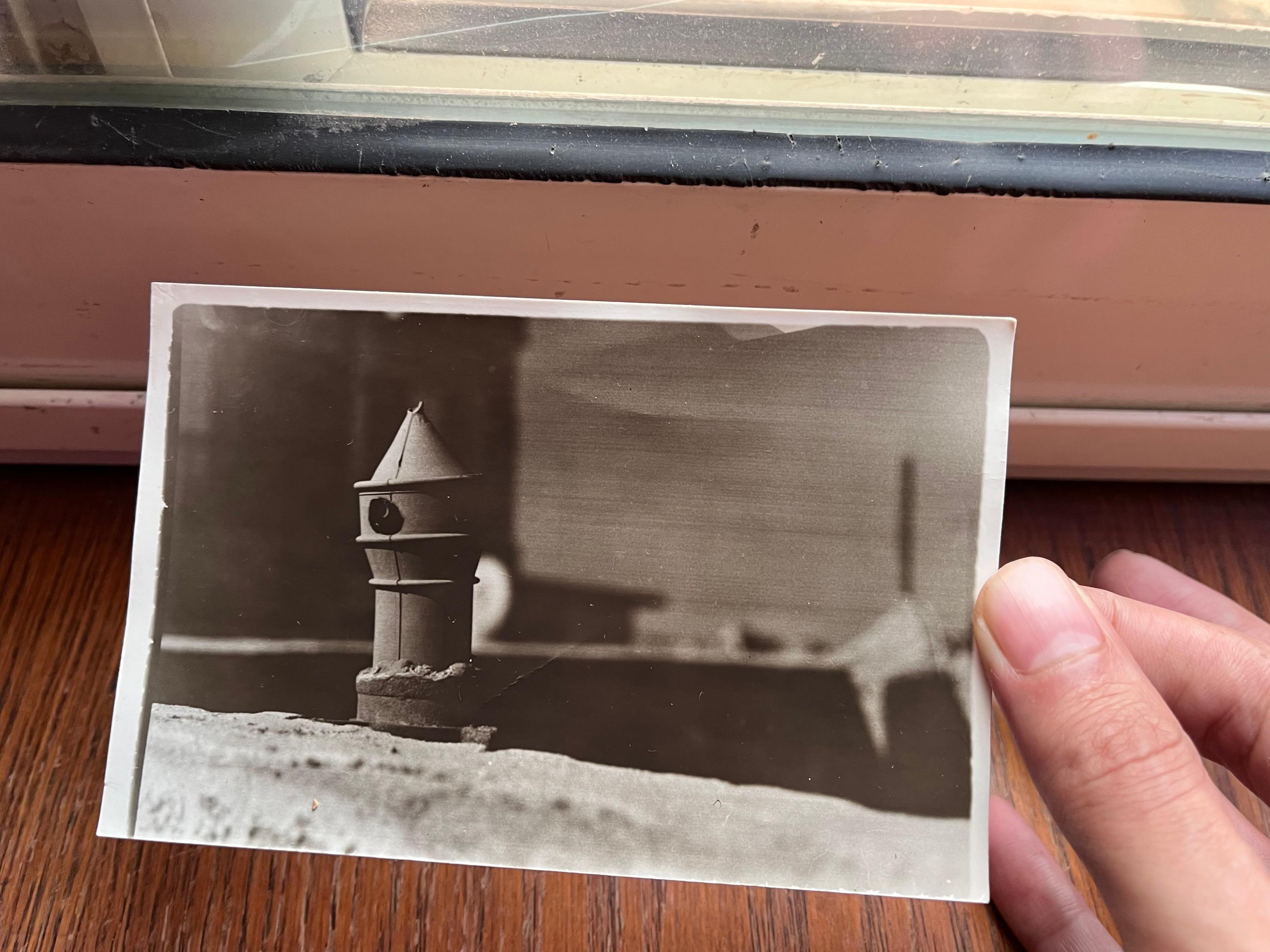

Follow up:
Test-print #1 (Kindly excuse the poor quality)
[snapped with iPhone and compressed using WhatsApp]
[White-balanced and converted to B&W with Lightroom]

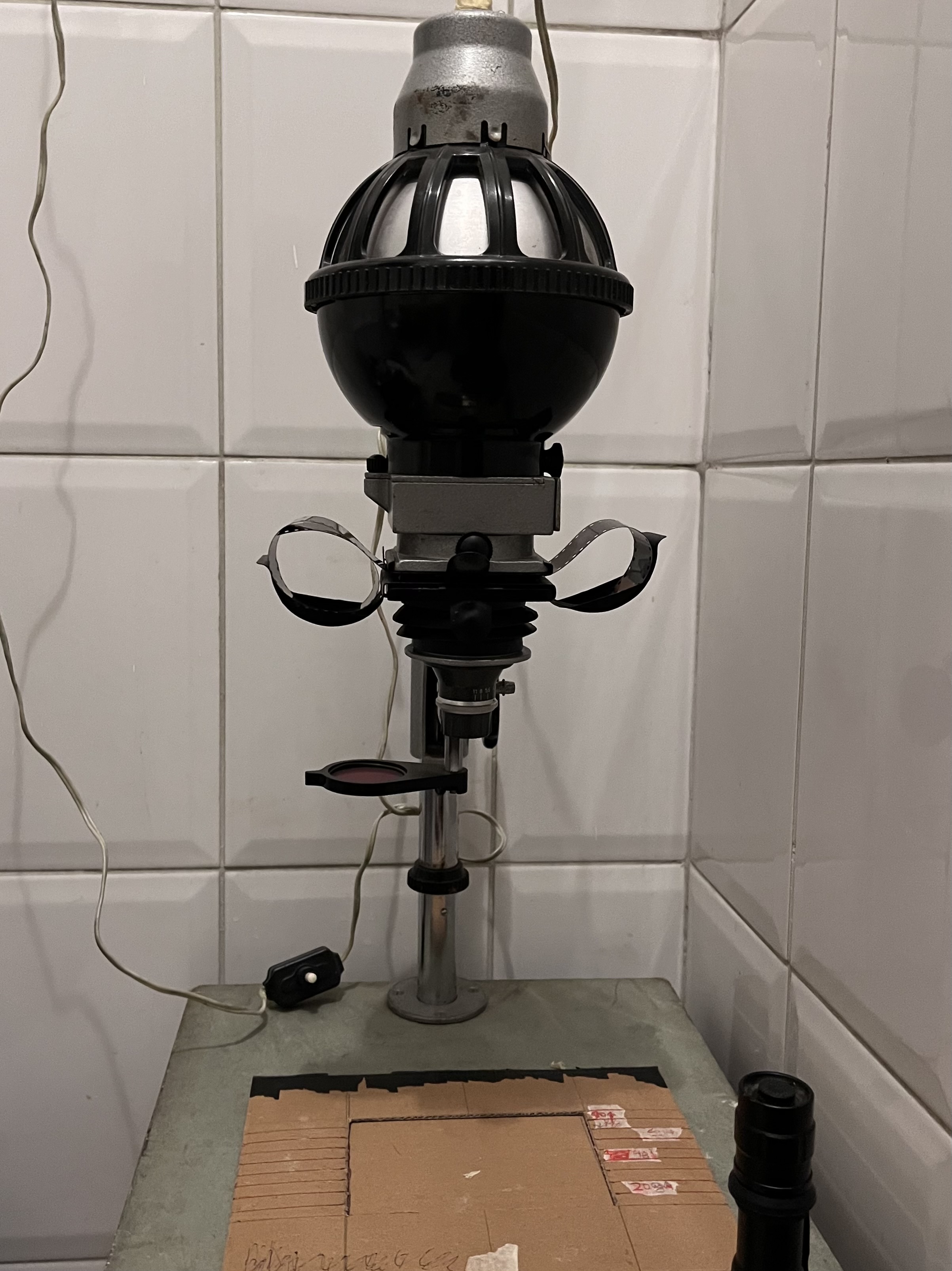

Paper: Expired [Orwo] Forte grade 4. Fiber-base/glossy.
Exposure: 30 sec @ f/5.6 (no dodging or burning).
Development: ≈ 2 minutes in home-brewed D72 1:1
Enlarger: A restored auto-focus Zenith Upa-5 with LED bulb and no contrast filter.
Feedback is most appreciated! 🙏🏽

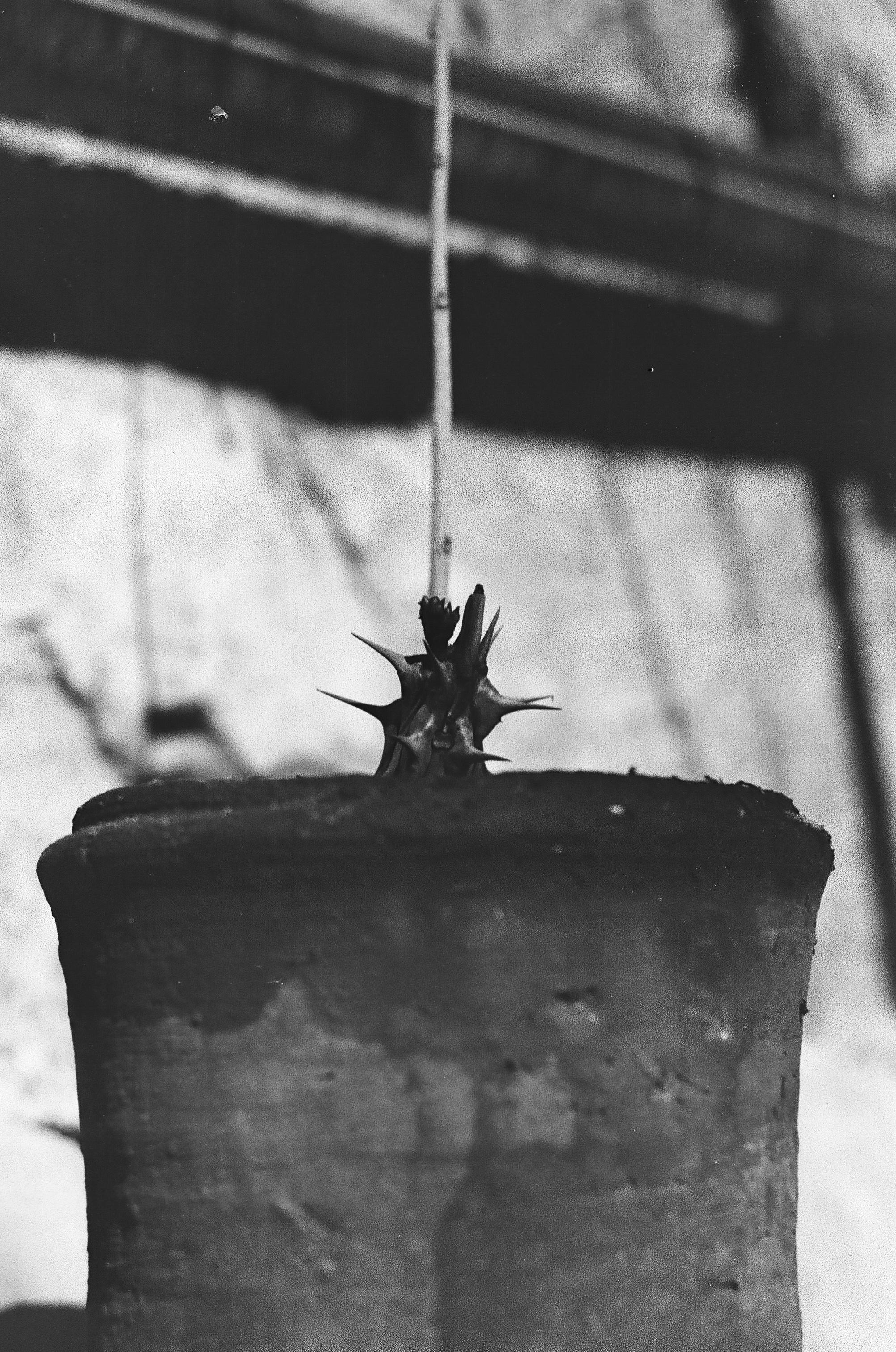

Update: Scans are finally here!! 😊
[Experiment scans as received from the lab. Mirrored] [Compressed using WhatsApp]
I’m happy that usable images were recorded at all and I like the results. (Considering how the film was shot and developed). I’d definitely like to take another shot at this.
What do you think about these and how do you think I can improve the results next time? Thanks in advance!

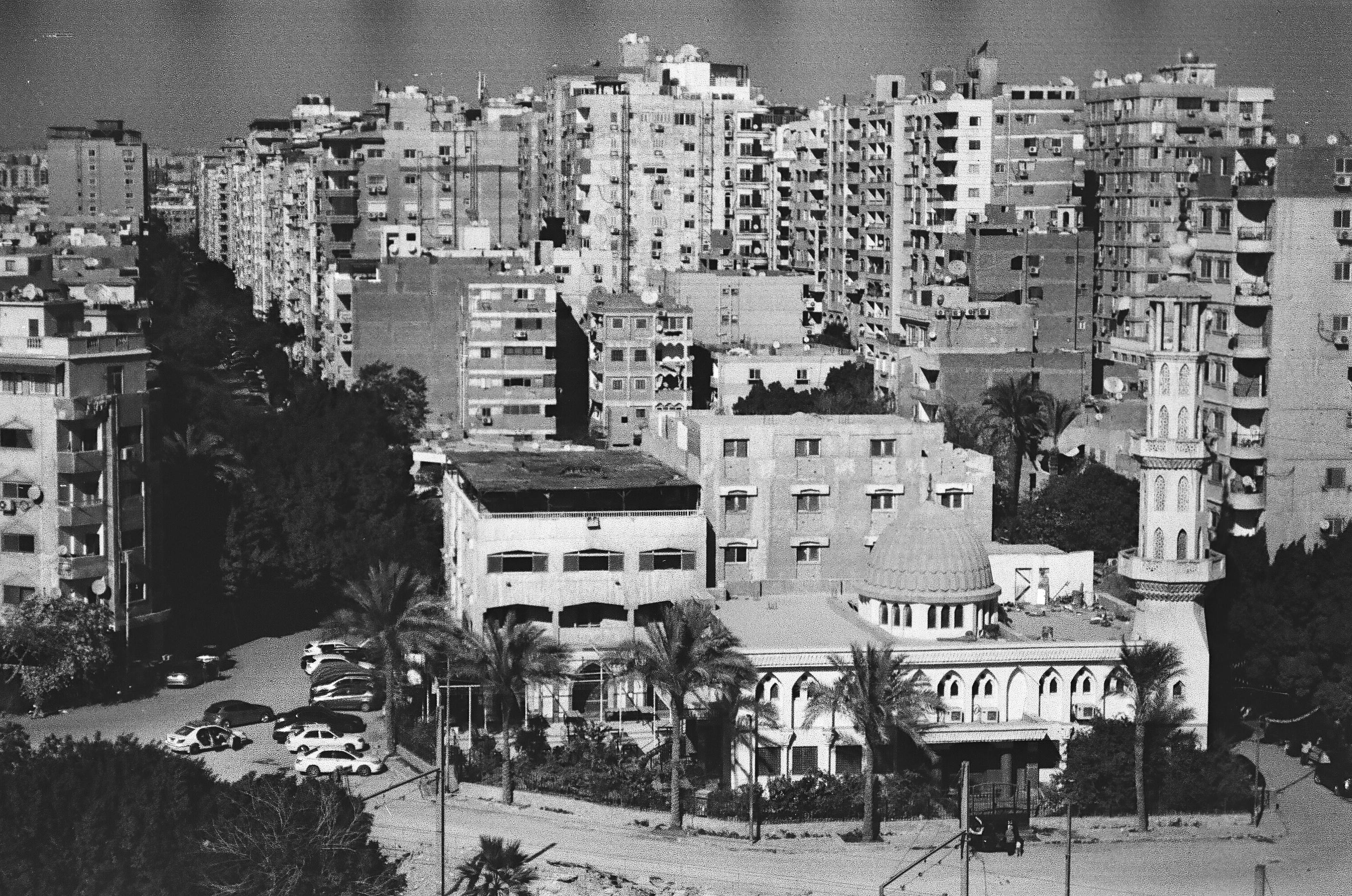

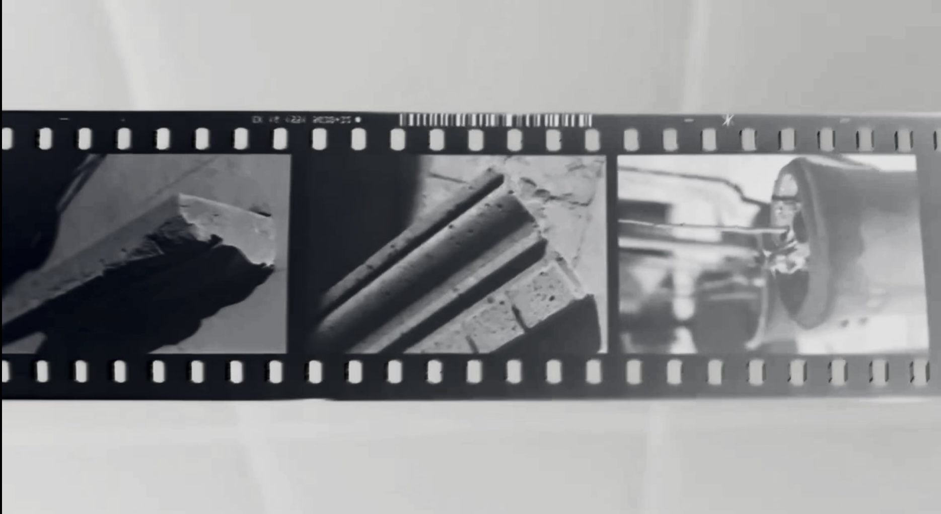

To compare:
The following are a few results from the same film shot regularly at EI200 and developed in the same way as the experiment (inverted) clipping.
[Scans as received from the lab] [Compressed using WhatsApp]

I notice that the first set (the images you photographed through the back of the film) don't scan too well. From a technical viewpoint, the regularly exposed frames are far superior.
O z
Feb 14, 2024
36
Cairo, Egypt
Can't argue there. Thanks for taking the time. Do you think it would improve if i overexpose by a stop or 2 next time i give it a shot? or is it not worth the effort and film in your opinion?
I assume they are the ones shot through the remjet coating. Which would explain this interesting texture.
Yes. The first set is the clipping that was shot through the remjet coating. I was planning on re-rinsing/drying the negatives when I get them back to make sure there’s no drying marks or remjet remains, then do another test print and check the texture again. I suspect both might be adding to the texture on this frame at least.
