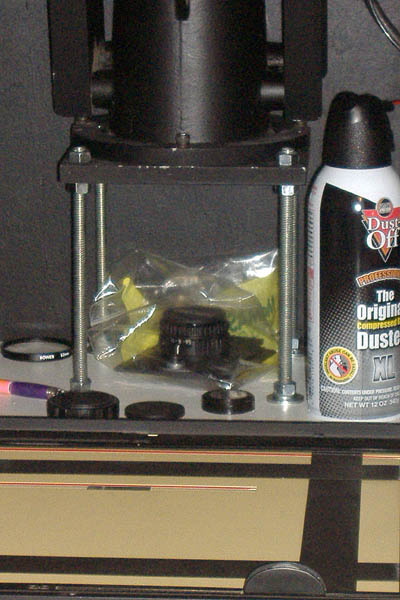

Dear Lorenzot,
I did this with my Omega. I was going to use steel tube around the threaded rod but it turned out to be more than rigid enough as shown.
Good luck,
Neal Wydra
