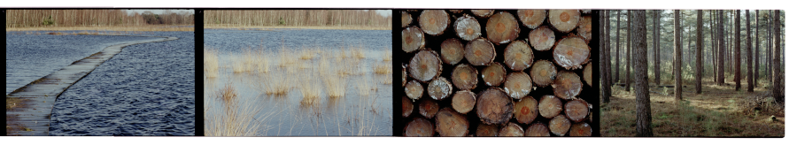

Yeah, I did that once (250D @ 800). Came out OK; a little punchy and of course some degradation of shadow detail. But it wasn't too bad.
Scans from optical prints onto Fuji DPII.
IDK what development time I used on these; I'd have to look it up. I figure it would have been something like 5 minutes or so. Maybe a little shorter. ECN2 developer at 41C.

Thanks for sharing, koraks. Quite punchy indeed. Would probably work out okay in not-too-contrasty situations, but maybe a bit too much for mid-day high contrast scenes. Perhaps 400 is a good sweet spot.
Keep in mind these are scans from optical prints, and today's color paper is really contrasty. If you scan, you're not bound to the contrast the paper gives you and it's also easier to lift the shadows. Here's a quick & dirty scan of the same strip of negatives:
You could color balance this in whatever way you want of course.
Ah yes, fair enough, those certainly seem to have more latitude. Thanks again!
