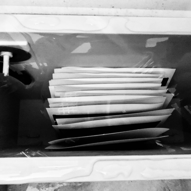

I own and love my Zone VI washer, but here and there I take out the paterson when I work with RC papers. Just more convenient to dip my hand into it, throw in smaller format papers, turn the papers upside down, and so on.
Here is a view from above my paterson washer, which stands into my deep sink.
What you see are 18 8x10 prints standing vertically. The sheer waterflow makes them separate, and which seems to be excellent circulation. On top and bottom of the image you see the water overflowing. There is a hole at the bottom of the washer which makes water circulate from the bottom and is driven up, this limits the water’s top limit and prevents overflowing, a very simple and clever design.
On the left of the image, just below the white vent, is my black hose that I have dipped about 4 inches in.
I sometimes agitate the hose inside the washer and move the prints around with it, this helps with washing and keeps my hands dry.
