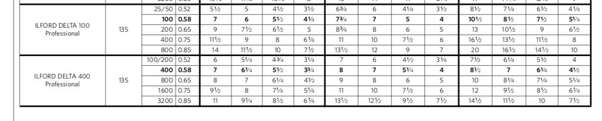

I've now had a chance to make a few test prints and suspect that Delta 400 - 8 minutes @ 21ºC is slightly too long, so 7min 30secs is probably about right, which is the time Kodak give for Delta 100. The timings of the slower film seem to be okay, so I'm somewhat at a loss to explain the much shorter figures given by Kodak for Delta 400 film.
