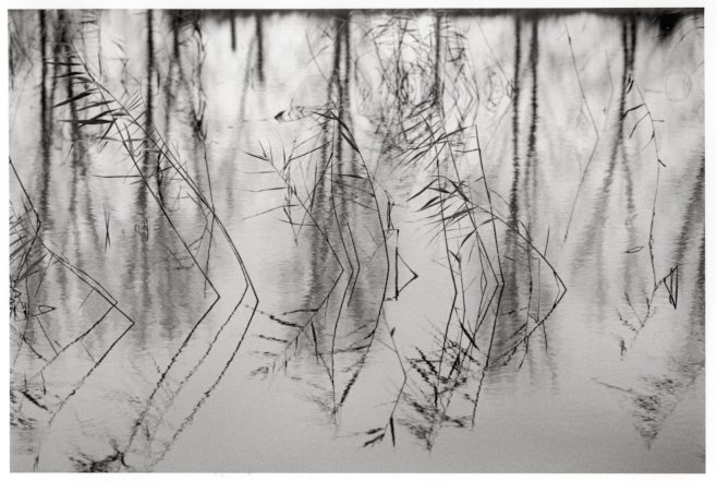

I printed this last night; it's 35mm HP5+ at EI640; it's shot under failing late afternoon light and the SBR was only a few stops, if that. Developed the heck out of it (winging it really) and printed this at...no joke, grade 1 or thereabouts. Plenty of contrast in the negatives. I wouldn't be held back by what 'they say' about expansion being difficult with modern films.
Looks very nice. Which developer did you use?
