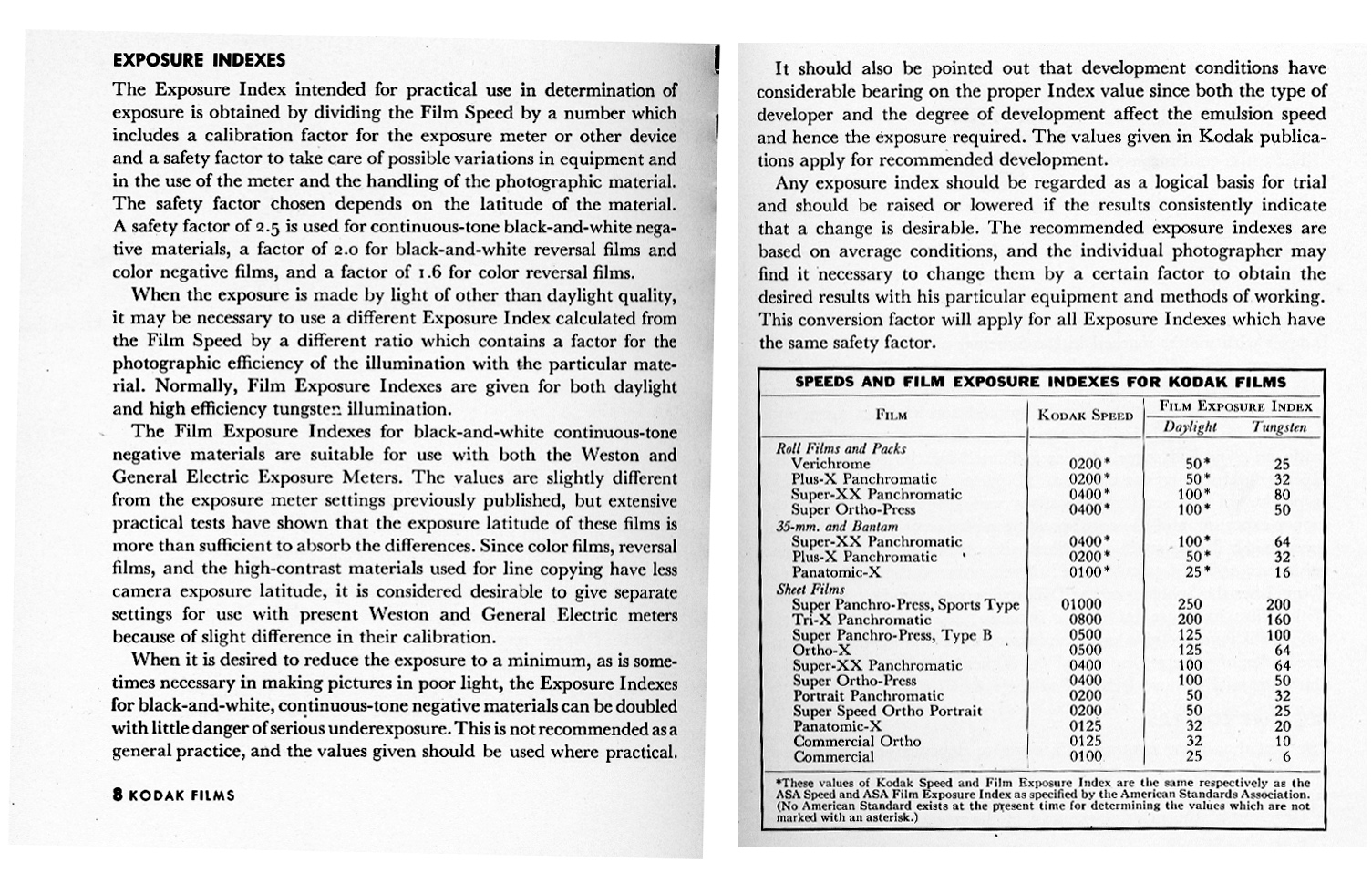

The use of different daylight and tungsten EIs were mostly discontinued sometime in the 1960s after the 1961 exposure meter standard changed the color temperature of its calibration light source. Allen Stimson, An Interpretation of Current Exposure Meter Technology, Photographic Science and Engineering, vol 6, no 1, Jan-Feb 1962 states "Among other innovations, meters will henceforth be calibrated at 4700K instead of 2700K to make them more accurate in daylight and eliminate the need of different tungsten speed for most panchromatic materials."
I've attached a copy of a couple of pages from an old Kodak Reference Handbook. It's very interesting.
