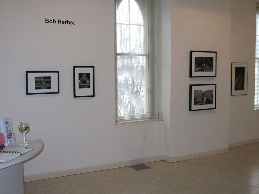

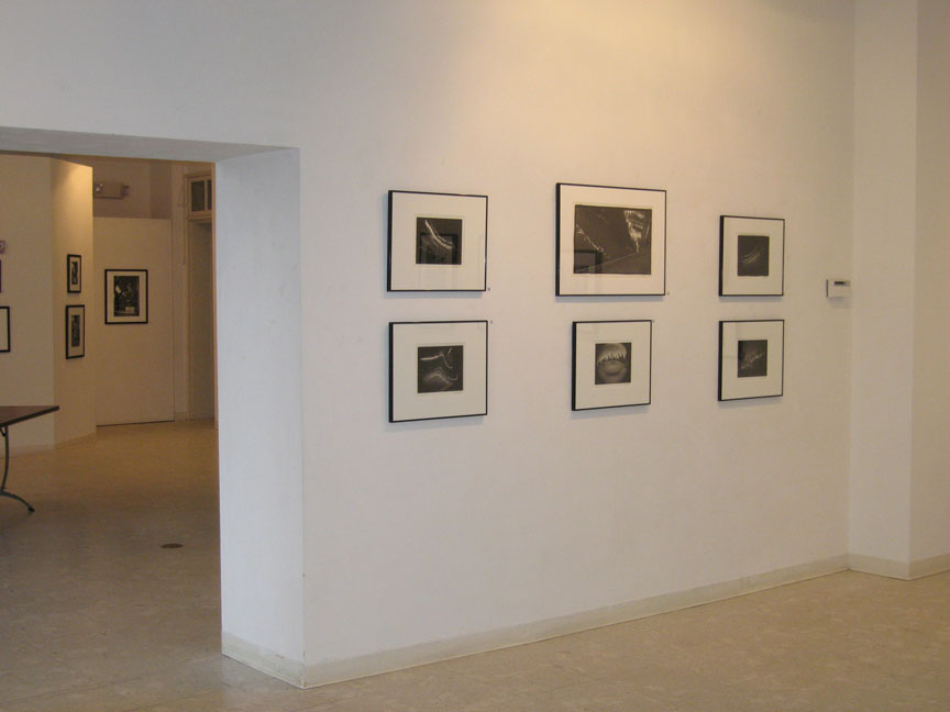

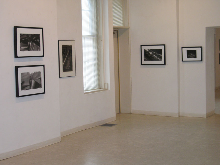

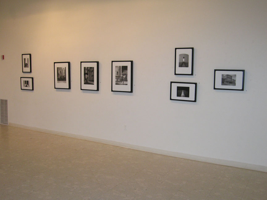

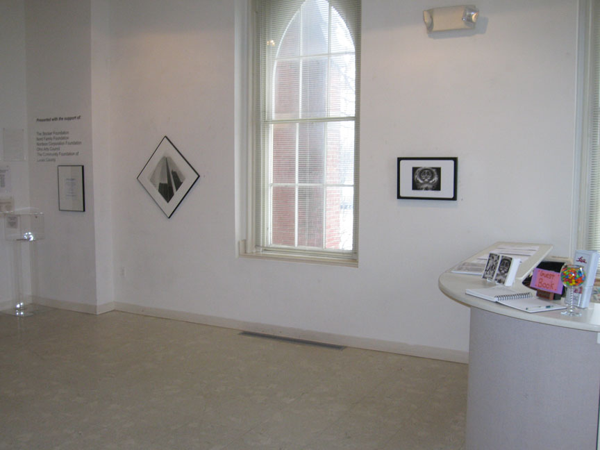

Attached are pictures from the gallery opening last Sunday. All of the carbon prints on aluminum were made with Bostick & Sullivan carbon tissue.
The gallery in Oberlin occupies most of the first floor of the building in the picture. Oberlin and Oberlin College are known as a a progressive community deeply supportive of the arts. The Allen Museum of Art is a few blocks away. They as well as the Cleveland Museum of Art have very impressive photography collections.
Last week, President Obama presented the Oberlin Conservatory of Music of Oberlin College with the 2009 National Medal of Arts at the White House. Created in 1984, the National Medal of Arts is the highest award given by the U.S. government to individuals and organizations that encourage the arts.
So it is somewhat of an honor to be invited to exhibit at the FAVA Gallery in Oberlin.
