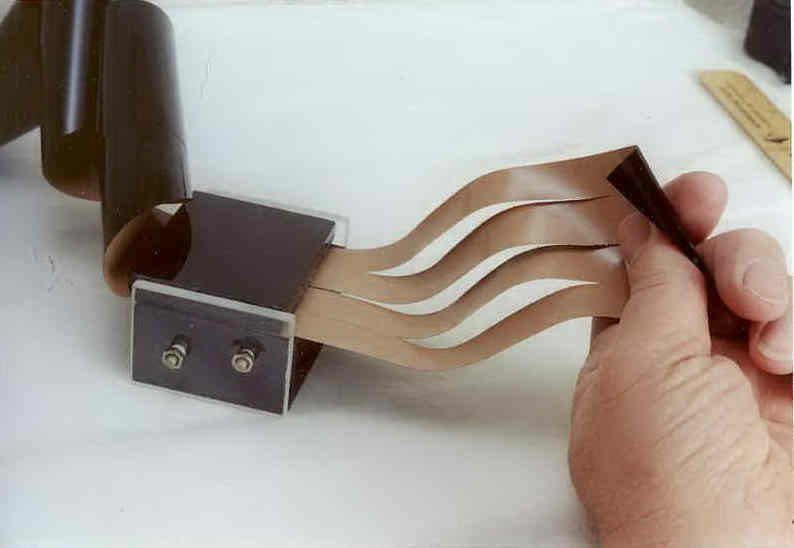

I have no relation to the person selling these, but wanted to share a great product. If you shoot 127 film or some other oddball film size no longer made, this film cutter works fantastic and is very reasonably priced. I use it to cut 120 film down to 127 format to reroll my own. I cut down and marked 120 backing paper; then cut, roll and tape the cutdown film on the prepared backing paper onto old spools. The can make them for any format/size.

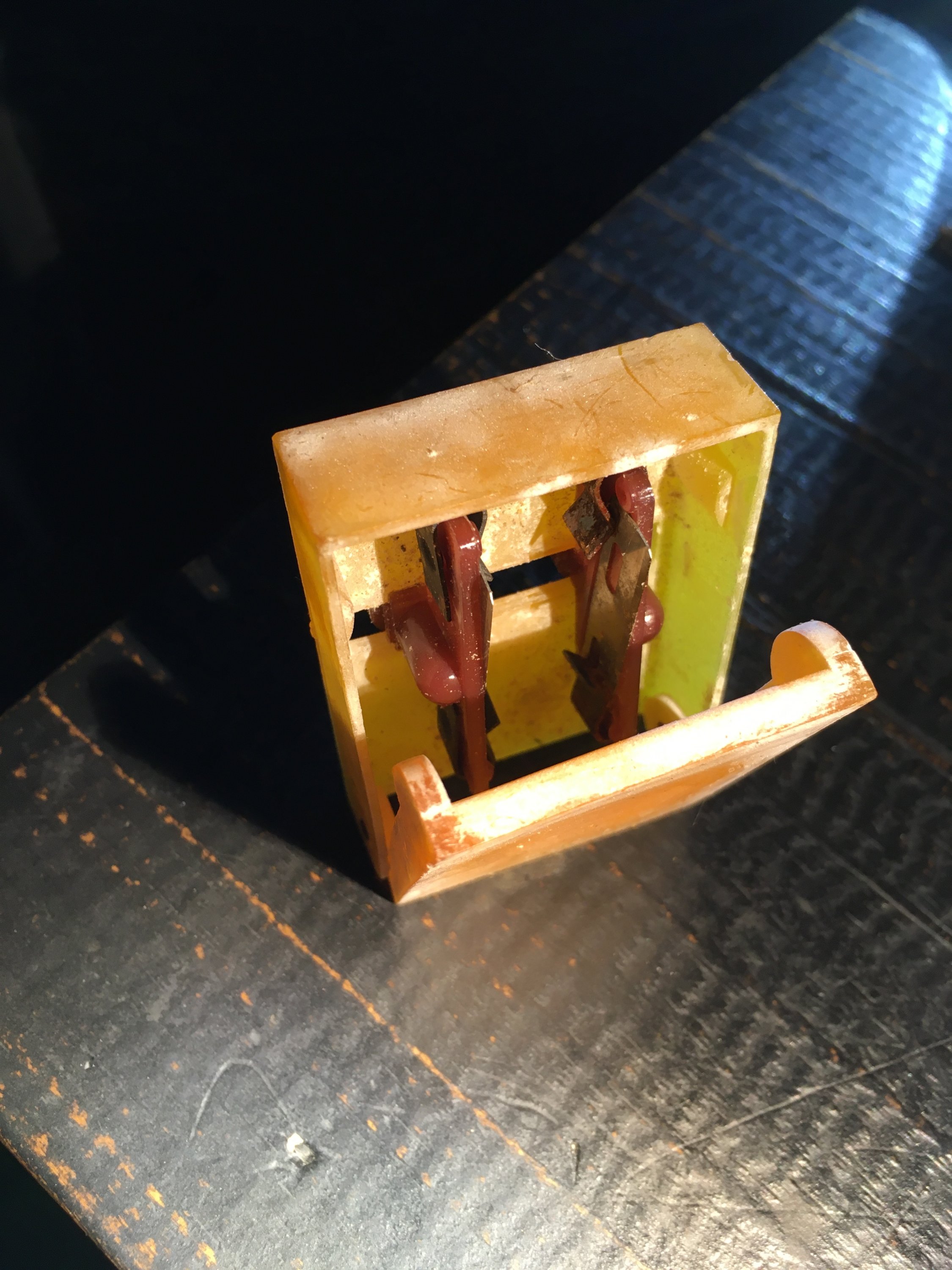

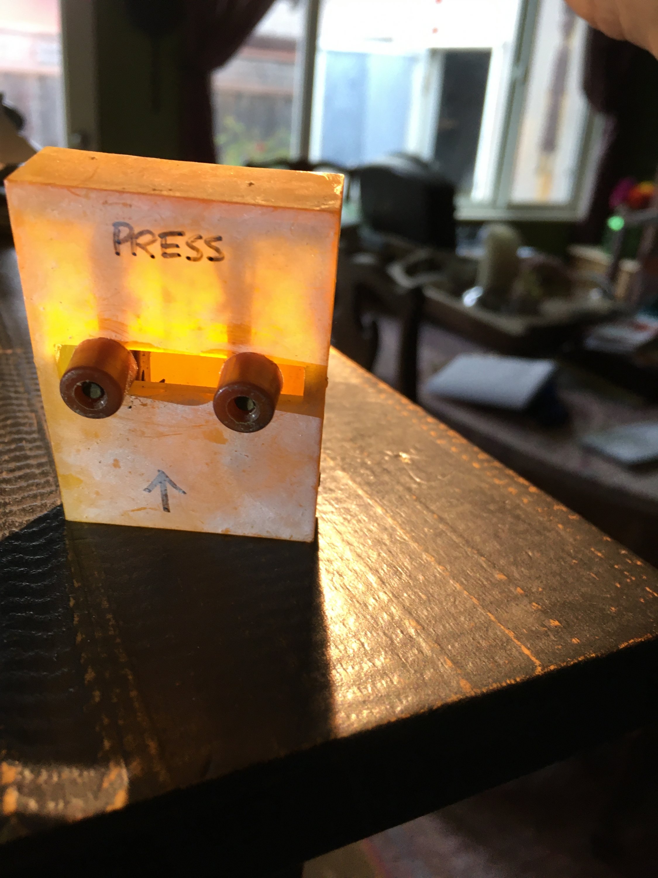

I was thinking maybe I should get one of those... then realized. Wait. I have this.
This was used in graphic arts. It was an accessory to the Merganthaler Headliner. And you used it to cut strips of headline tape. The tape was a 35mm film format but the film was paper.
