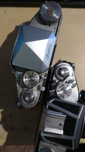

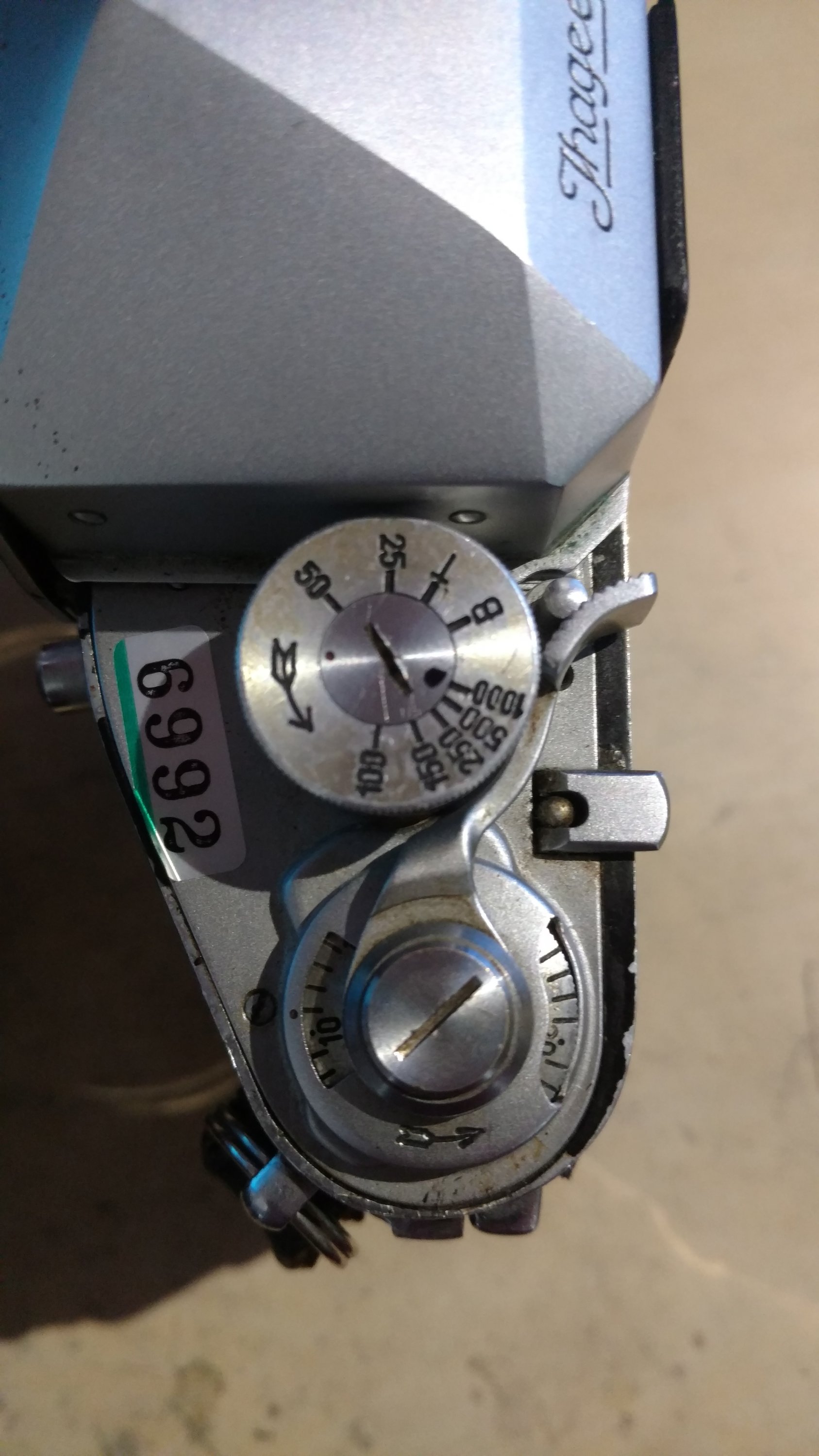

I decided to figure out what was wrong with an Exakta Varex I bough on eBay and I found something weird. The shutter speed indicator or the little dot on the screw doesn't line up with the actual speed. Also the timer isn't working, if you try to set it then it will just start I going and won't fire the shutter. I took the screw out but it just tightens back to the wrong spot. Any suggestions? Also I can't find the right manual for it. It has no manual counter like the other Exaktas I have. I will post a shot of the camera and another of it up against an Exakta vx I have. I made my own dot that lines up with the correct speed.

Depending on the model there may be a washer under the securing screw for the speed dial. Perhaps it's missing. If it turns too far for the mark to align, substitute a slightly thicker washer. If not far enough, a thinner one or sand it down until it's good. It doesn't need to be super tight, just secure. You may need to use some abrasive paper to fine tune the fit anyway. It's an easy fix.
Are you setting the timer correctly? You should have slow speeds marked to 12 seconds and delay speeds marked to 6. If you're in the range to 12 seconds and not on B or T at the main dial it probably won't delay. You can use the timer range at any speed, and this should provide delay before firing the shutter at 1/1000, 1/500 or whatever speed is set on the main dial. At B or T you should get delay, plus whatever time you set the timer dial to. Of course, no matter what you're trying to set the shutter must be cocked, first.
The other possibility is that the gear timing is incorrect. You can mesh them at many combinations of teeth but only one will actuate the lever that trips the mirror and starts the exposure after the correct delay. Some other functions may work OK at incorrect timing settings, but only one will see both timer and slow speeds working at all settings as they should. I know this as a result of successfully re-timing a Varex IIa from scratch a few years ago after a professional repairer made a mess of re-assembling it (the receipt for the "repair" work with some incriminating notes came with the camera).
If you're definitely operating it correctly, you'll have to take a deep breath and dive in there to re-adjust it until it's good. Take a good look at the gear peg that trips the mirror lever. If you can get that positioned so that the timer has the right delay, the slow speeds should then come in OK when the system is re-assembled: but check them all, anyway.
