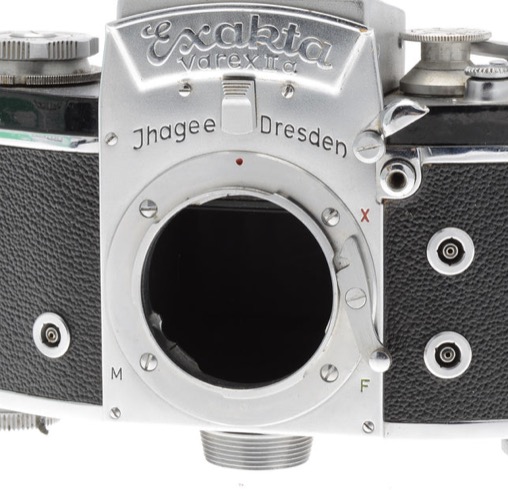

Hello! I've recently been getting into the Exakta camera system (by far my favorite 35mm slr btw) and was wondering if anyone would happen to know if m42 to exakta mount adapters existed. i can find Exakta to M42 (putting an exakta lens on a m42 camera) but nothing the other way around. Is this a situation where the flange distance is too short so it wouldn't work, or is it one of those things that's uncommon enough to require a $200 adapter (like Contax rf mount to LTM)?

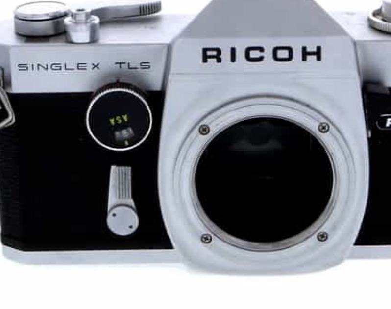

If the goal is to put an M42 lens on the Exakta body, I would remove the Exakta's lens mount (4 screws) then source a dead M42 body (Practika, Ricoh, Sears, etc. etc.) take off the lens mount from the donor camera, re-drill the holes, and mount it to the Exakta body. You might have to make the replacement mount a little thinner (by sanding it or turning it on a lathe) to achieve infinity focus.

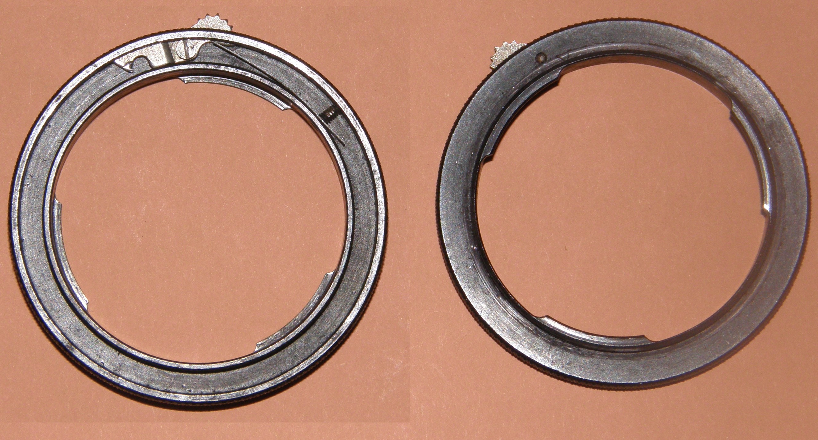

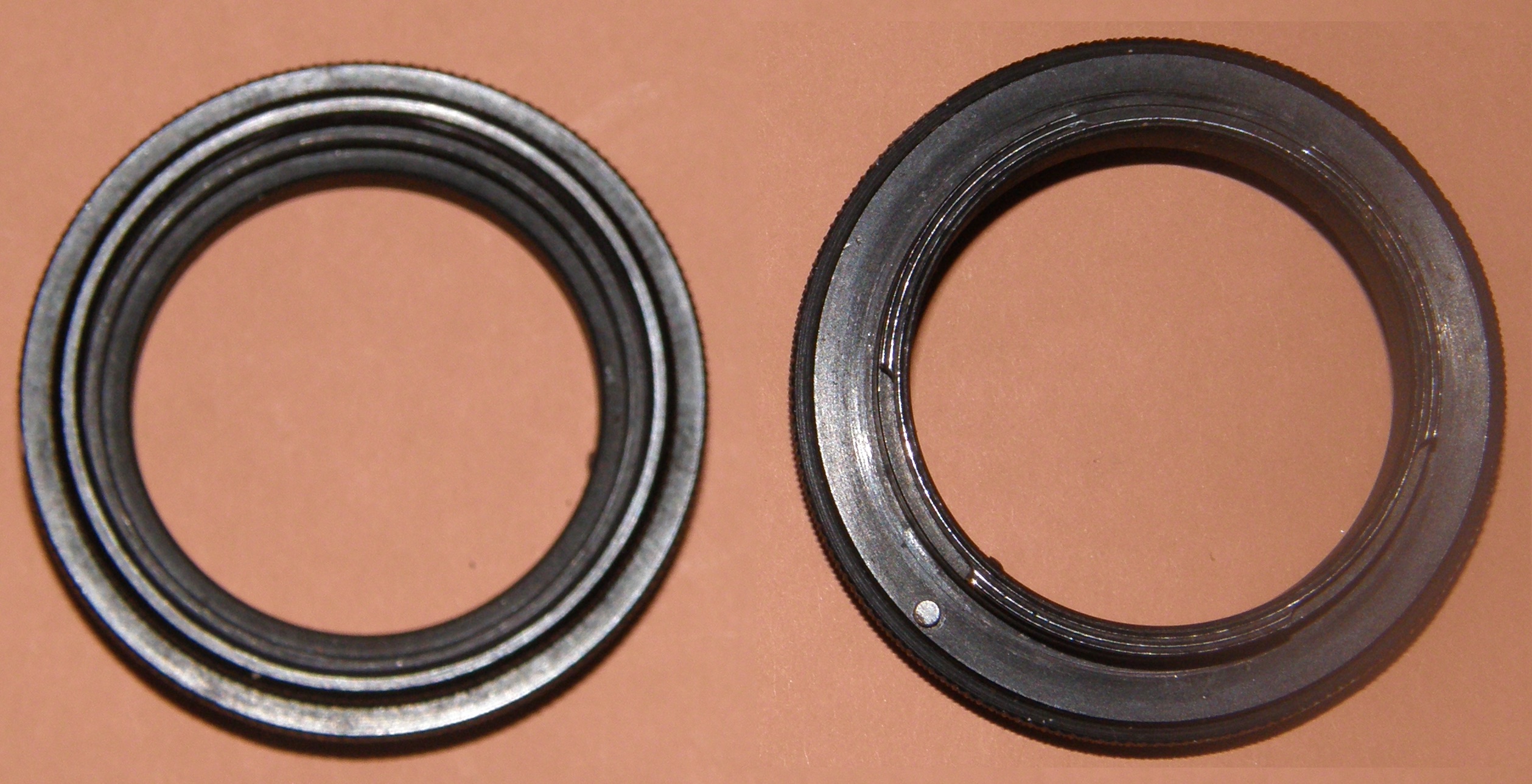

I read this thread, then was going thru a bag of some old Exakta stuff in it, and in a fantastic coincidence, found these 2 adapters that go both ways between M42 and Exakta cameras. The first is an Exakta lens to M42 body adapter; the manufacturer dealt with the shallower flange focal distance of Exakta lenses by having the lens stick into the M42 body a bit. r a feldman is correct in his above comment-- the adapter threaded walls are very narrow, indeed light can be seen at a couple points (it wouldn't matter in use, as it would be buried in the female M42 thread). The 2nd is, AFAICT an M42 lens to Exakta body adapter, with (darn the luck) another smaller adapter screwed and stuck inside-- it's smaller than M42 but bigger than M39, so both M40.5 and M40 are possibilities (each was used for a hot minute on some camera system, but I'm damned if I remember the names). ETA: probably it's an M40 Praktiflex lens to M42 body adapter, and would be for close-up or macro work on M42 as it wouldn't make infinity; it would be closer on an Exakta body but the thickness of the adapter stack likely makes infinity impossible.
That is super cool and exactly what I'm looking for! Now that I know they exist, my search is not in vain.

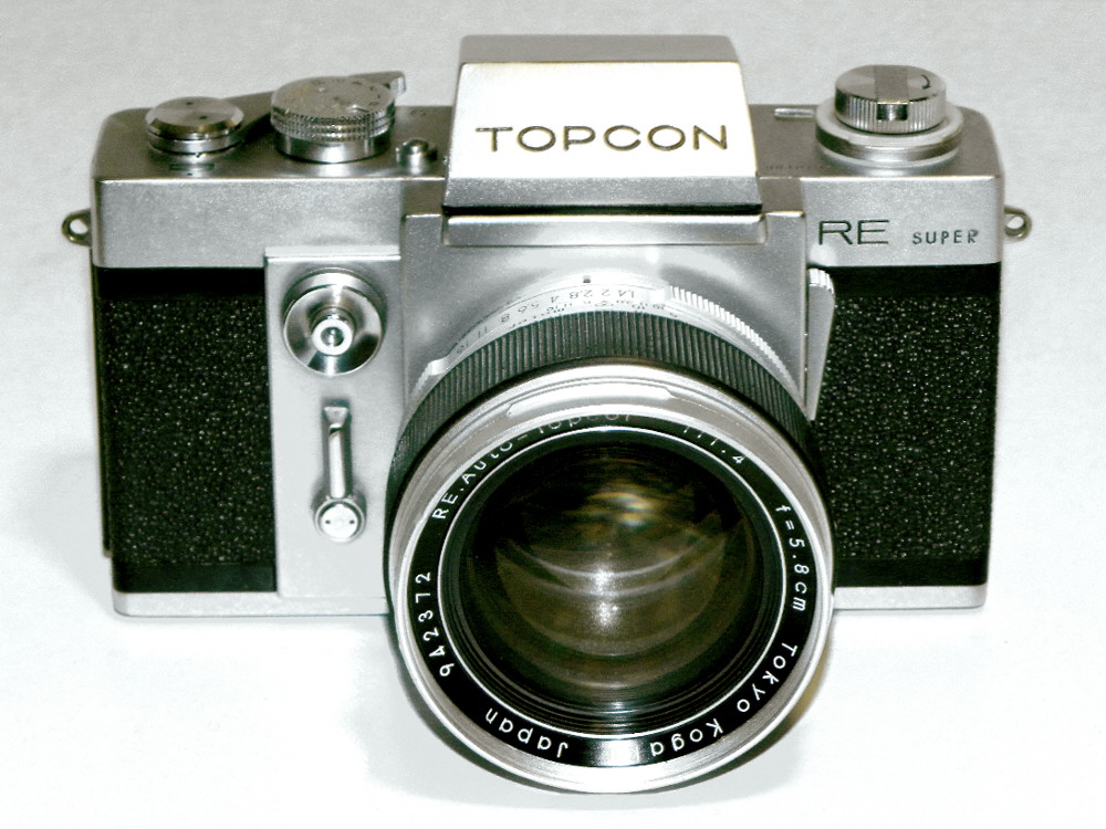

You might want to think about a Topcon RE or D. Topcon made 2 lines, the consumer line used a Topcon developed mount the UV mount with leaf shutter in the body. RE and D, were top of their 35mm line used the Exakta mount, the D, Super D, and SuperDM were system cameras that competed with the Nikon F, think of the Re as Topcon's answer to the Nikormate. Unlike the F and F2, the meter was in body, so the user had TTL metering with waist level and sports finders. Topcon used a standard are right handed releases. The D and SuperDM was used along with the Canon F1 by the Navy until Topcon stopped making cameras around 1977. There is some informatin around the web as which lens compatible. I also recall that Topcon did make a M42 to Extakta adpator as well. The last RE was a K mount, they did not make many as it came out just before Topcon left the market.
