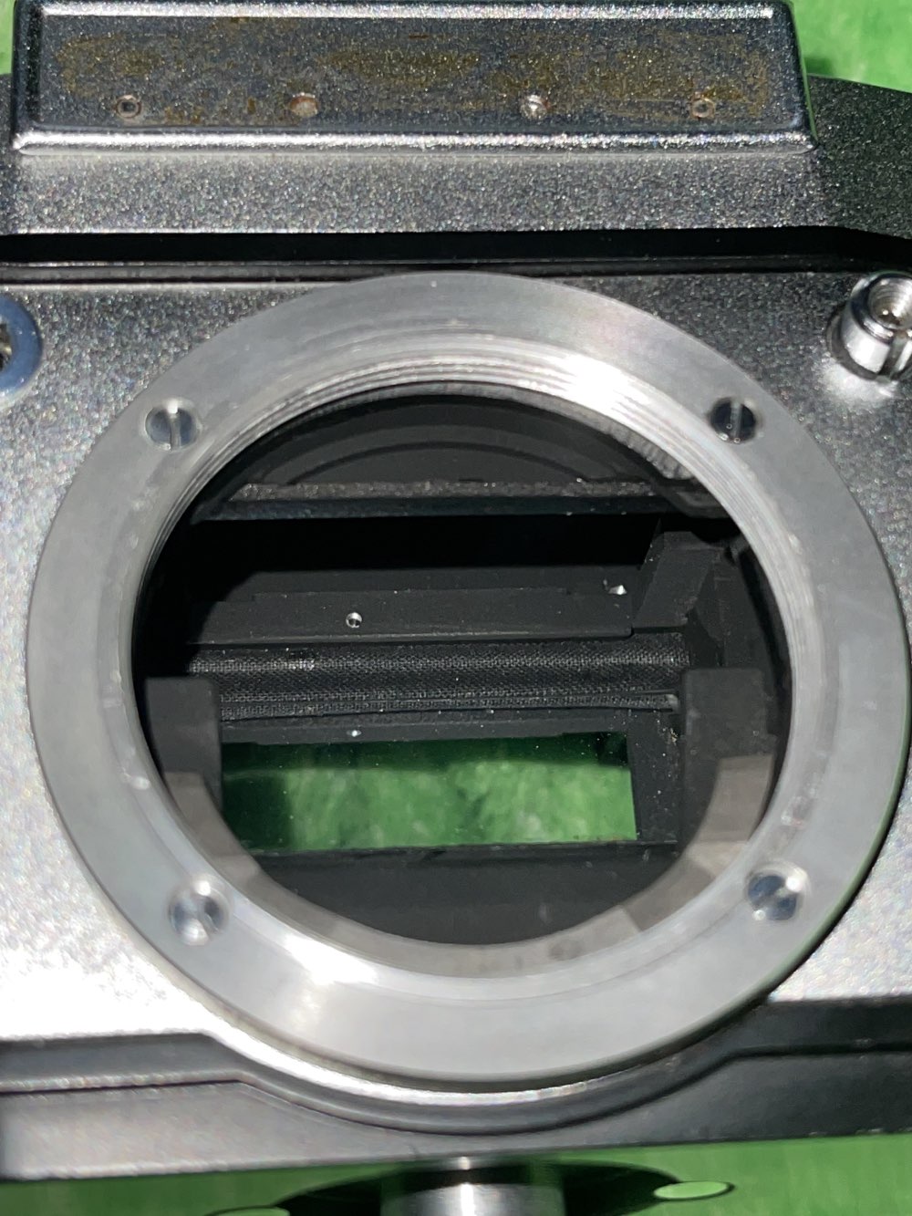

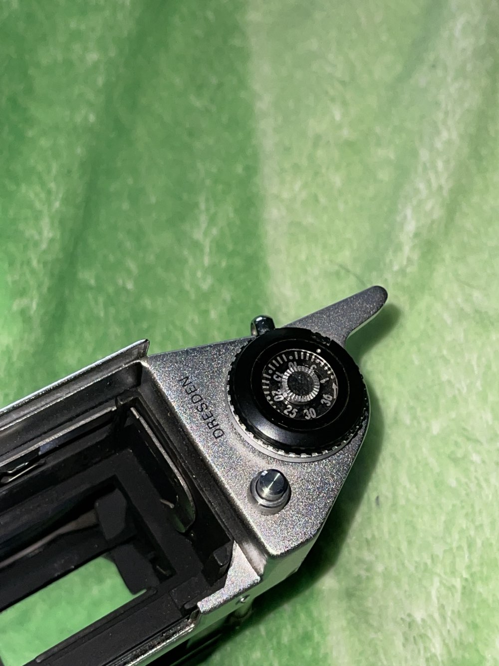

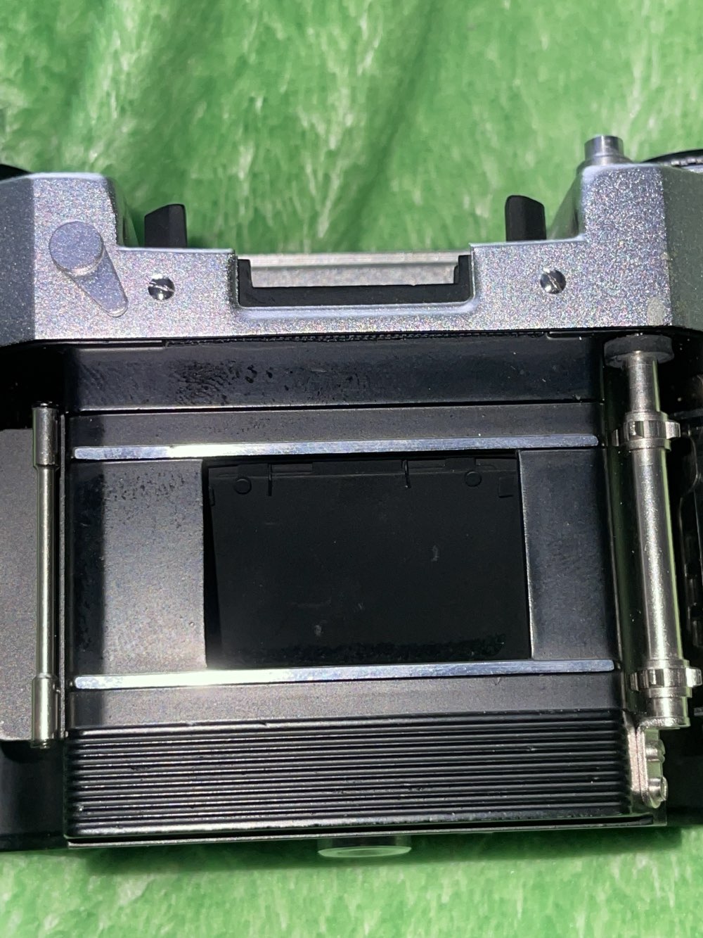

The shutter seems bunched up in front of the mirror? I feel like this shouldn’t be like that can anyone confirm that this may be the heart of the issue?

Ok so by holding down the shutter and bringing back the lever at the same time the mirror became unstuck. You can then operate the camera as usual but you must manually push the lever back each time. To get the lever to return on its own, I had to loosen the screw in the Center of the film counter. Only problem is as you wind film, the screw tightens again and over time the problem reoccurs. Maybe replacing the compression washer beneath the film counter could be a fix?
