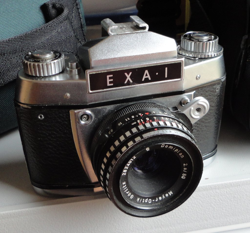

I have an old 35mm camera, Exa-1. This is the camera:
