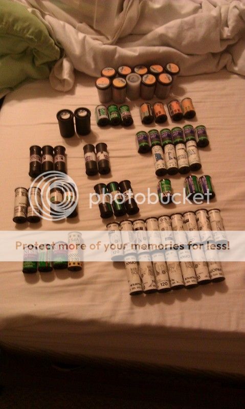

Yeah,I need to get going. Some of these are years old. Hoping for the best.

I had 4 rolls processed when I posted this. Luckily my chemicals are still good but I will need to get more to finish all these. Is fixed reusable,I reuse hypo and photo flo but I have not been saving fixer.
