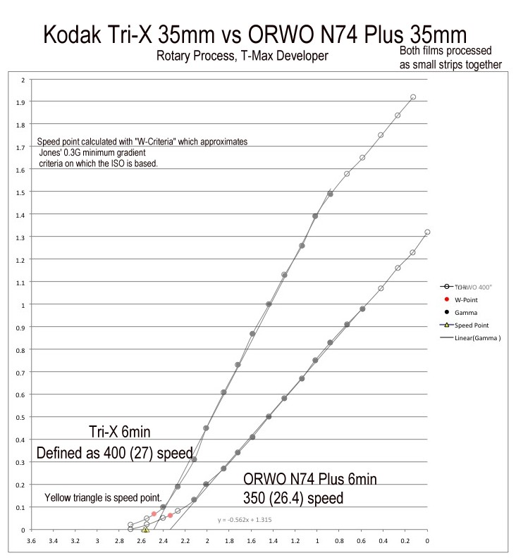

I thought those were paper curves you posted. When testing the developer activity of film, I do a linear regression of the first 10 or 11 points after 0.1 and use that as an indicator of development activity.
For example you can see the line and the solid black dots (the datapoints for the line) in the diagram here.

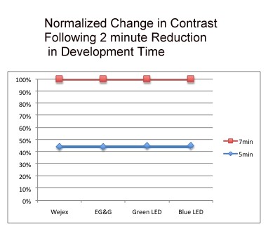

The question was answered. The slope of the curve is the developer activity.
Sensitometers with glue or green or white light won't affect one's ability to determine changes in the slope.
The one sensitometer I have does not keep the film flat due to its design, and does not give enough exposure for a 100 ISO film at max setting. Working with it in complete darkness is a very painful and annoying endeavor, and then I'm unsure how best to store the test strips also. The test spots are also so extremely small that they are difficult to accurately measure. Sensitometers are also really hard to buy it seems in comparison to densitometers. This is why I'd rather use a light source and step wedge
