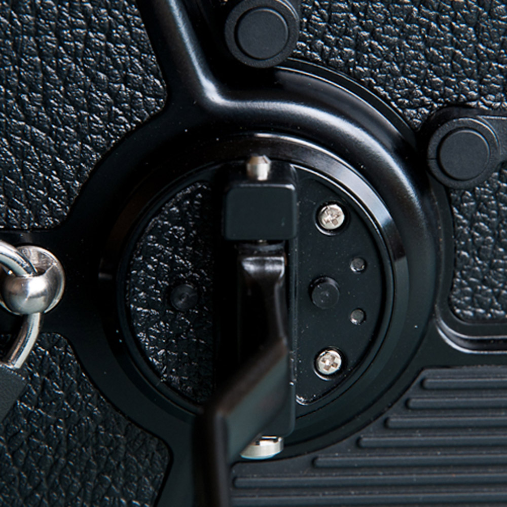

Regarding the missing bit, I have now found out it is not on the film rewind it's on the film advance, so I just need to work out how to cut it and stamp the hole in it now.

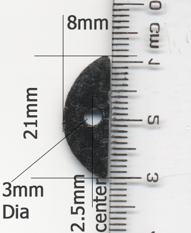

Another idea, I will remove my other half circle, measure and scan 1:1 (Ill post on here just in case anyone else find it useful).

This image is 300dpi and should be 4.04cm tall when printed (the ruler scale should obviously match)
Posted here for anyone else who finds it useful.
Just to add I think if it was a complete circle it would be 24mm Diameter, worked out in photo shop and checked on the camera winder.

All cut and ready to fit now.
I punched out a 25mm circle (closest punch to 24mm I had readily available)
Cut the 8mm deep arcs out
Punched the 3mm holes with a hand hole punch
Thought I would change both so that they match 100%
Job Done!
