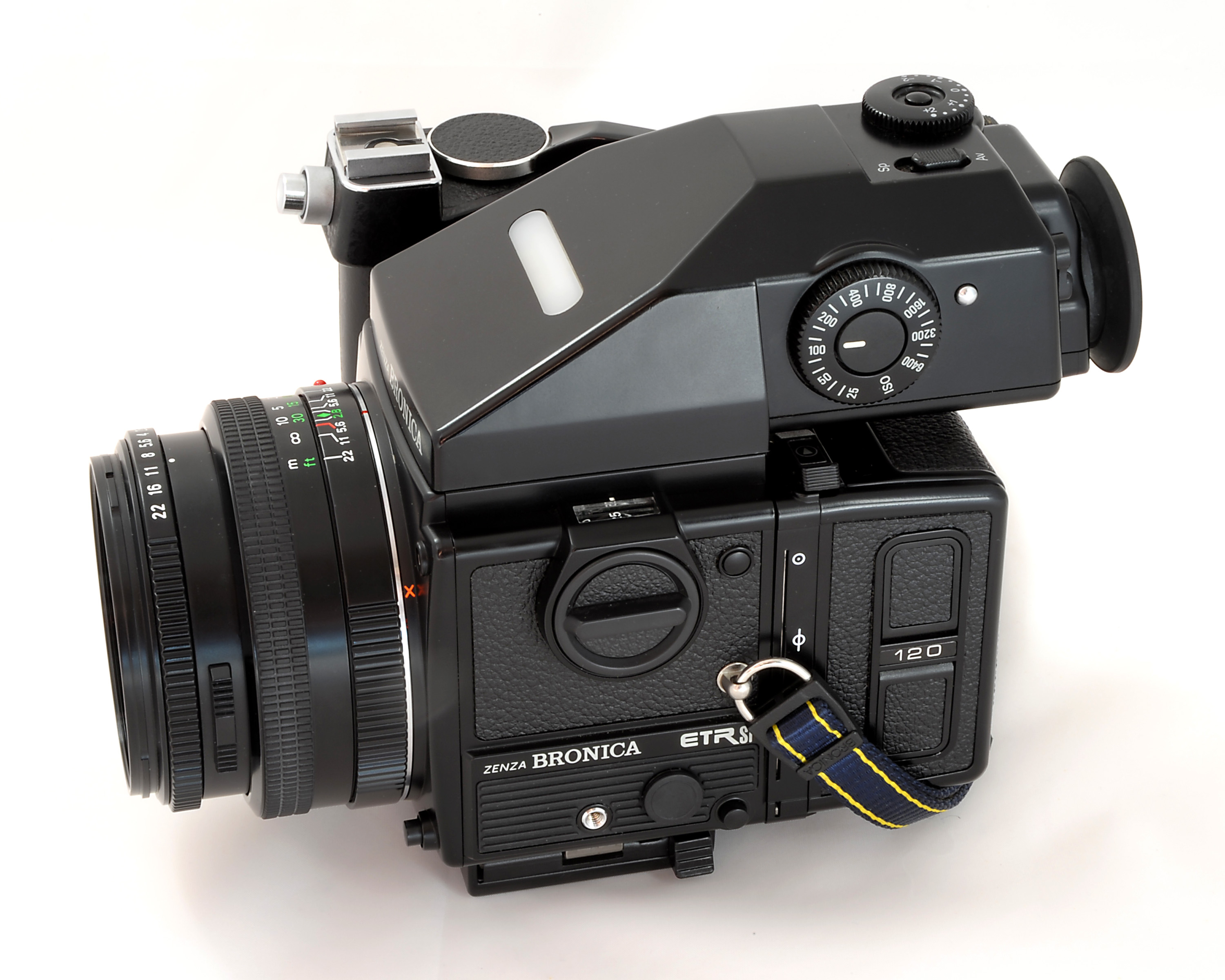

I used to use an AE ii prism on both by ETRS-i's in the past but sold them along with all by other Bronica items. Now that I have bought my ETRS-i back what would you recommend?
WLF - Its on the camera but a nightmare if you turn to portrait
Plain Prism - Cheap and does not drain battery
AE-ii - Will cost a little extra but does have a light meter (and I have used before)
AE-iii - The one I could never afford in the past, may have found a deal with one, but I have read they can make the viewfinder image darker
Remember I am buying this camera back for 95% to look at and 5% to use, but for that 5% I want to enjoy and not fight with it!

I managed to get hold of an almost mint AEIII so I have this on the camera with a speed grip now. Must take it out and put some film through it now!
Can't see the Bronica replacing my D3s as the main camera, however I am looking forward to putting film through it again after all these years.
