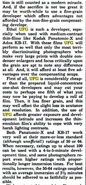

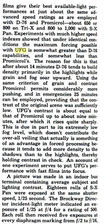

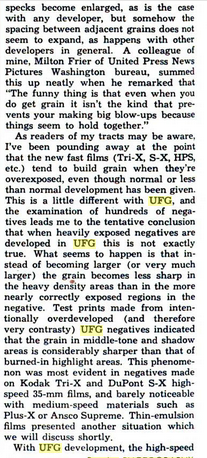

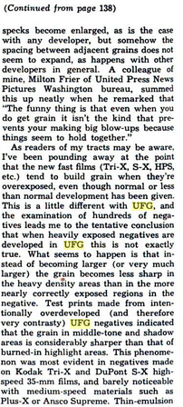

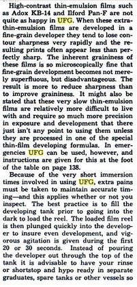

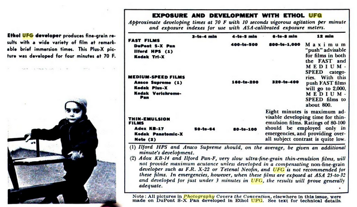

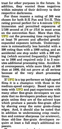

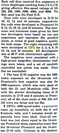

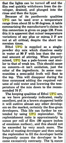

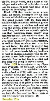

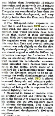

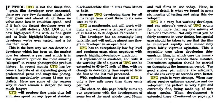

Yes, UFG came in cans to make a quart -- and so did the UFG replenisher. I'm attaching 13 files that together are a full review of UFG in 1956, just for background. Now all you need is some DuPont S-X or Ansco Supreme film and you're all set! Actually, UFG works perfectly well with modern emulsion IMHO.
