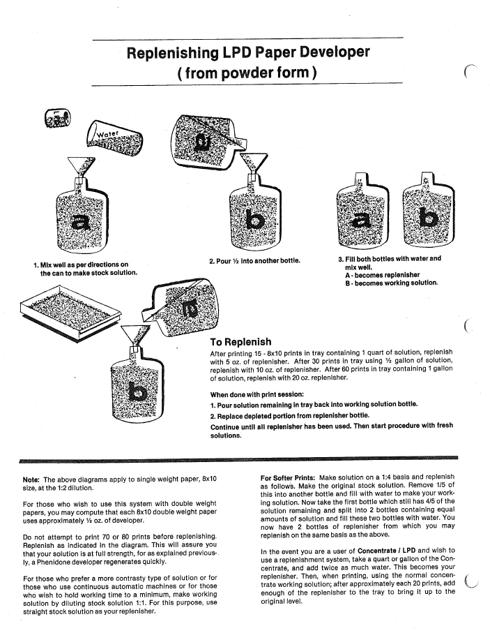

Here are the instructions I base my calculations from - the powder version in my case:
I'm not sure, but the reference to "Concentrate/LPD" may be a reference to the liquid form.
This happens to be the last page of this, undated booklet that I have a pdf version of. The other 9 pages of that booklet all deal with Ethol film developers.
Thanks Matt. That's the same PDF from which I extracted the final paragraph on replenishment.
My questions still remain, the replenishment instructions for the liquid (assuming that's what's referred to as the 'concentrate') are still unclear to me given the dilution I'm using. Maybe I'll switch to the powder form of the developer since it's less than half the cost of the liquid and not bother with replenishment at all.

So I would replenish the 1:4 working strength solution in the development tray using the replenisher made 1:2 from the concentrate?
That's how I read it, yes.
It's also what makes sense, because the replenisher is generally (always) a more active version of the working developer. As such, it wouldn't make sense to have a 1+2 replenisher for a 1+2 working strength developer, since this would mean you start at a certain level of activity and this will consequently drop over time as replenishment progresses.
The exact rate of replenishment seems like a bit of guesswork and I suppose that's inevitable; it'll depend what kind of paper you process - esp. fiber vs. RC, since FB will soak up a little more developer and thus, your replenishment rate will be higher, even if the actual emulsion is the same. In practice, this likely won't matter too much, in particular because paper development goes to completion, so as long as your developer activity + developer time are sufficient, you'll be OK.
That makes sense. However, the instructions on the bottle mention that one possible dilution for the working strength solution is 1:2. So if your 'normal working strength' is 1:2, then having a replenisher mixed 1:2 wouldn't make sense, given what you said above.
I'm still confused 🙂

So this is a replenishing scheme of your own invention?
This is also the system I use. It is outlined in the above posting #3 by Matt.
I use 1/3 oz per 8x10 for replenishment after a session.
Yeah. Then the other remark would kick in that "hey, it's going to completion anyway, we're close enough...."
In case of doubt:
* Do a development test at the start of a session (or halfway) to establish the minimum time to reach dmax
* Replenish a bit more
It's safe to err to the long side with development and the high side with replenishment.
Don't overthink it; just give it a go, see how it pans out.
I use my paper developer (not LPD) replenished as well and basically just wing it. I'm getting away with it, too...
